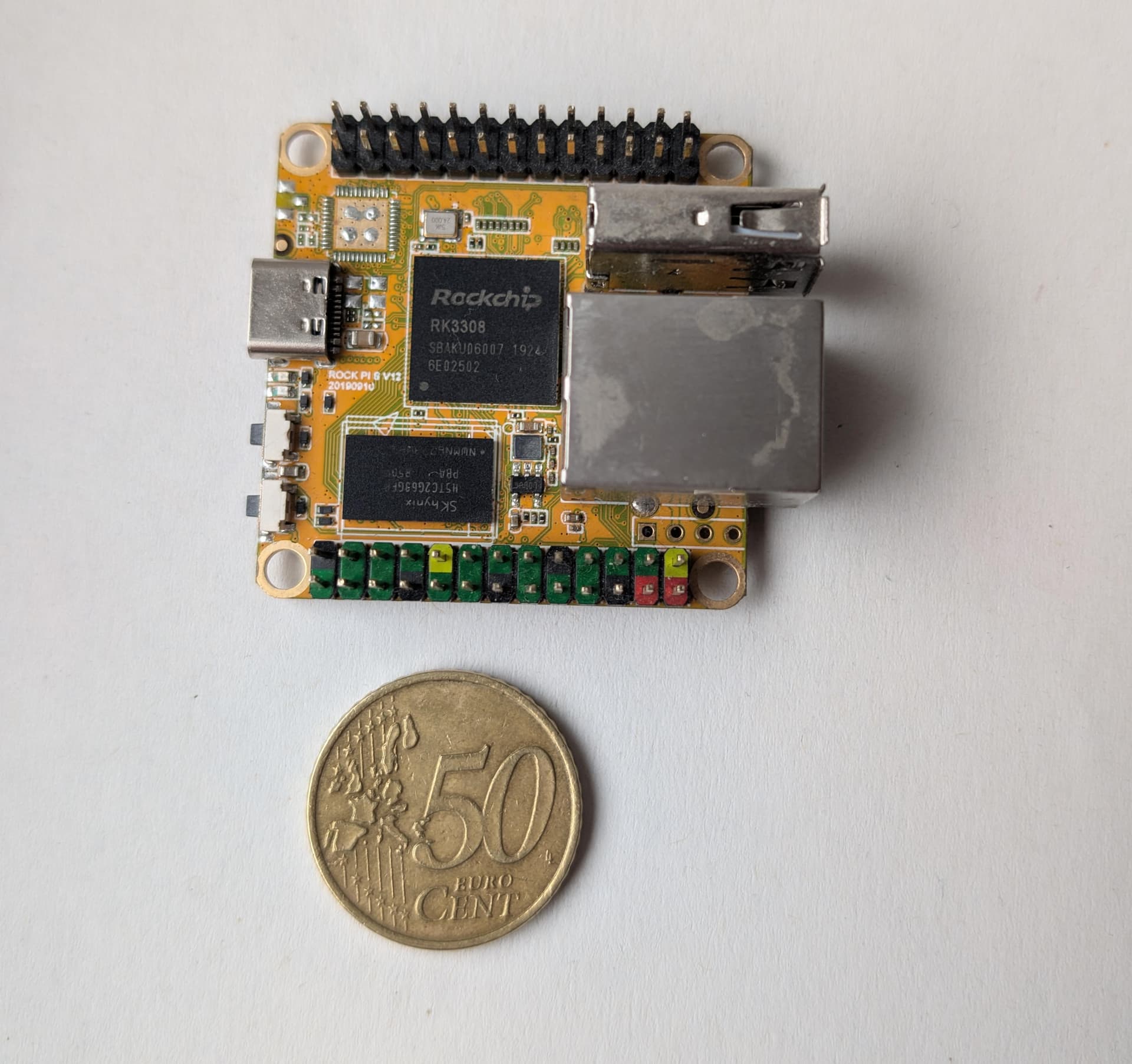

I’ve been tinkering with the Radxa Rock Pi S lately and wanted to share some of my insights in case someone is interested. It’s a great SBC, but like a lot of Radxa boards, the vendor images leave you stuck on ancient 4.4 or 5.10 kernels and are poorly maintained.

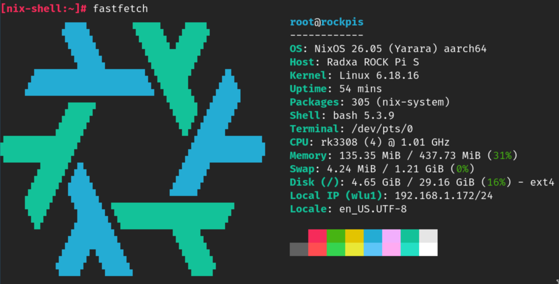

  • Kernel: Running the newest kernel ([6.18.16])
  • Working: [Everything / you tell me]
