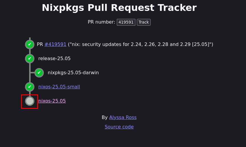

What does this mean compared to
This means that you can switch to -small channel and obtain the bugfix right now from the cache or you can wait for full integration testing to pass and obtain the upgrade.
(again, if you are that much in a hurry, you probably should eat the rebuild.)

As a noobie user of NixOS, I’m not sure what I am supposed to do ?
I am using flakes with nixpkgs.url = "github:nixos/nixpkgs/nixos-25.05";
nix --version returns nix (Nix) 2.28.3 which is affected from what I understand
Running nix flake update followed by a nixos-rebuild switch did not change that
It seems to be related to the fact the build(?) is not done yet as showed by Ten in this message
If yes, how much should I expect it to take ?
And what should I do then ?

Yeah, the nixpkgs builds aren’t finished yet. Honestly, the impression I get is that unless you’re running a public nix CI system, there’s no great panic. As a “normal” NixOS user, anything you build is presumably ending up in your system configuration anyway, potentially getting executed as root, or the very least your normal user. If any of that’s coming from untrusted sources, you presumably have bigger problems than a sandbox escape. [Edit: looks like I’ve missed something or misunderstood - see emily’s analysis downthread.]
I’ve swapped my VMs/servers to Lix out of an abundance of caution, everything else I will just wait for the nixpkgs hydra builds to complete.
  • nixos-25.05 updated a couple hours ago (7284e2decc98)
  • nixos-unstable updated right now (30a61f056ac4)
  • nixos-24.11 in about half a day, I assume (f25c1bd2a6b3 most likely)
Unfortunately, the thousands of NixOS tests are pretty expensive for Hydra, and changing Nix rebuilt really lots of them (not surprising, as every NixOS surely has Nix or Lix), and this got repeated on the three supported branches and mixed with some other smaller rebuilds on the same branches.
Moving fast for security issues was the main motivation for creating the -small channels/branches, I believe.
