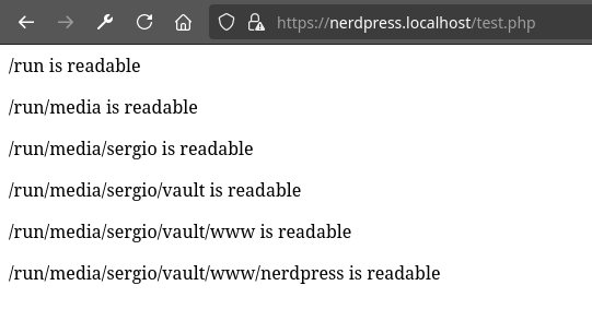

specifically what i mean by this is create a file called something like test.php at the root of one of your sites and in this file you should try to list out some paths on the file system and see if you can access them… then, when you access test.php from your web browser the script will be executed under the constrained systemd environment and you will see exactly what paths are available and what paths are not… try a bunch of paths like: /run, /run/media, /run/media/sergio, /run/media/sergio/vault, /run/media/sergio/vault/www, /run/media/sergio/vault/www/example.org, and you can see where the phpfpm engine loses access… maybe this will give us some hints?
I think the server can read all the directories fine:
<?php
$dirs = [
"/run",
"/run/media",
"/run/media/sergio",
"/run/media/sergio/vault",
"/run/media/sergio/vault/www",
"/run/media/sergio/vault/www/nerdpress",
foreach ( $dirs as $dir ) {
if ( is_array( scandir($dir ) ) ){
echo "<p> $dir is readable</p>";
