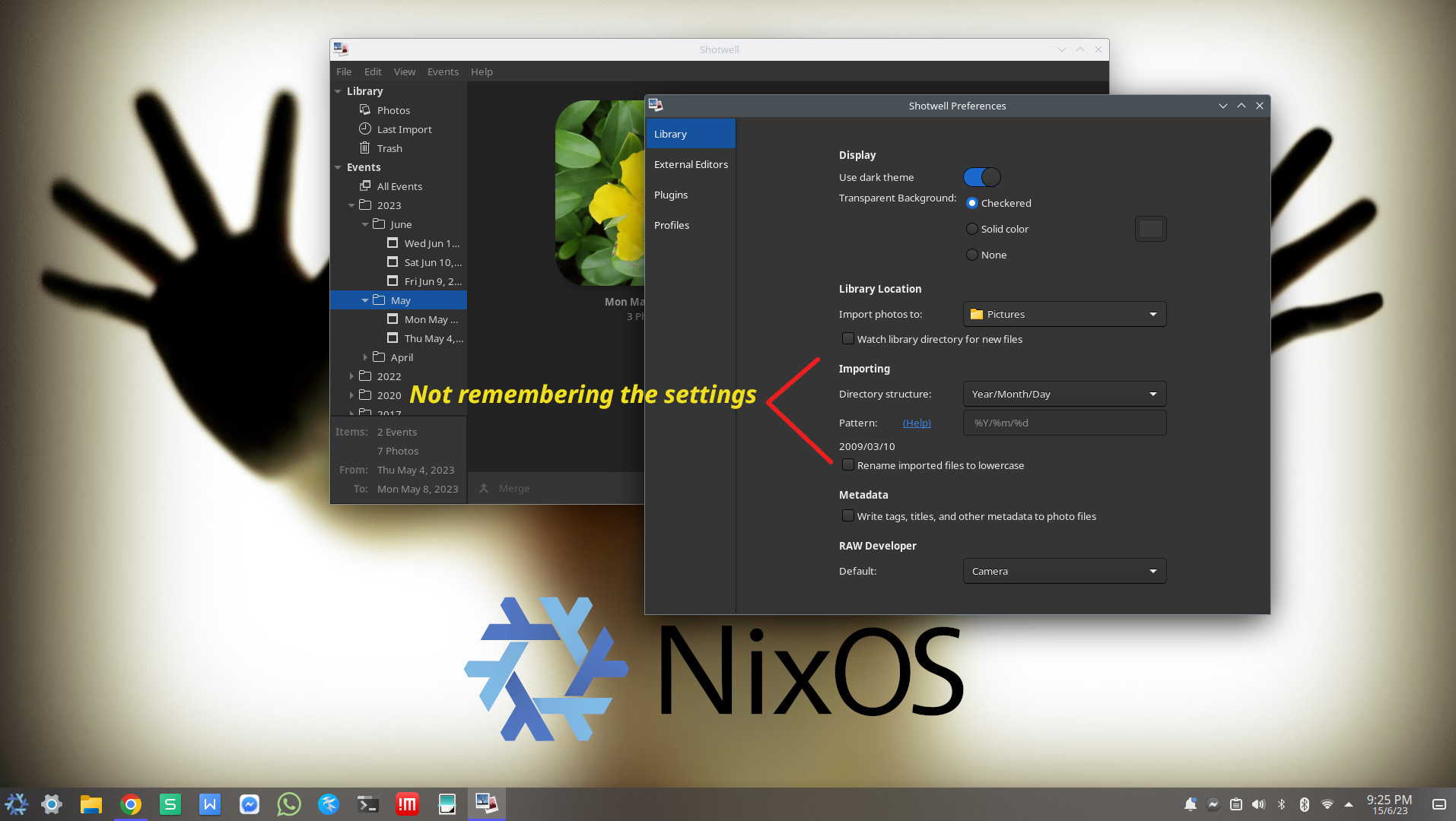

Hey everyone,
I could really use some help with Shotwell on NixOS 23.05. I’m having trouble getting Shotwell to save its preferences, like the watch picture library for changes and other settings (date format, etc.). I’ve tried a few things already, but nothing seems to be working.
First, I changed the permissions of the .local/share/shotwell and .config/shotwell folders to 777, hoping that would solve the issue. Unfortunately, no luck there.
I also made sure to add Shotwell to both the environment and packages sections in my “configuration.nix” file, just to be sure it’s properly integrated with NixOS.
If anyone has come across a similar problem with Shotwell on NixOS 23.05 or has any ideas on how to fix this preference-saving problem, I’d really appreciate your input. I’m open to trying out any suggestions you might have.
Thanks in advance

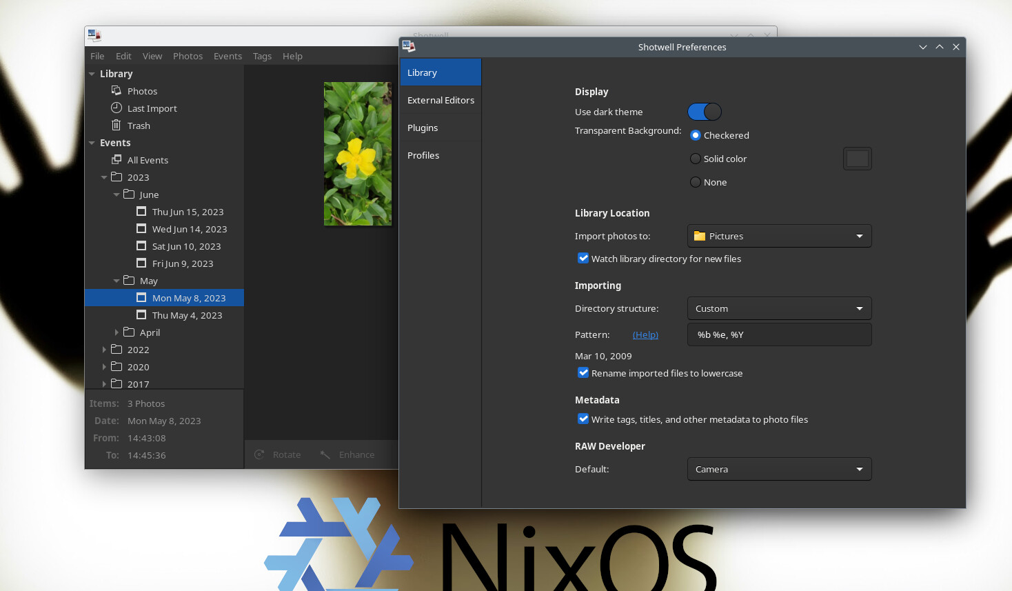

That did the trick!
