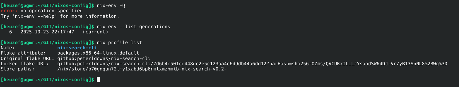

That looks correct. What about nix-env -Q and nix profile list?

Doesn’t using nix profile break usage of nix-env?
Yeah, that’ll be the issue. You most likely have two separate home-manager installations, one of which uses your channels, and the other is installed with your system flake.
It seems that the home-manager that you imperatively installed is taking precedence over the one installed with your system flake. Figure out how to uninstall the latter; I think the home-manager command (which you most likely have installed) has a command for that.
