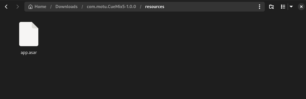

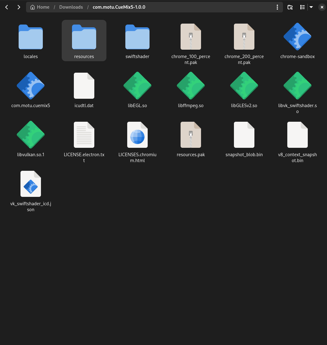

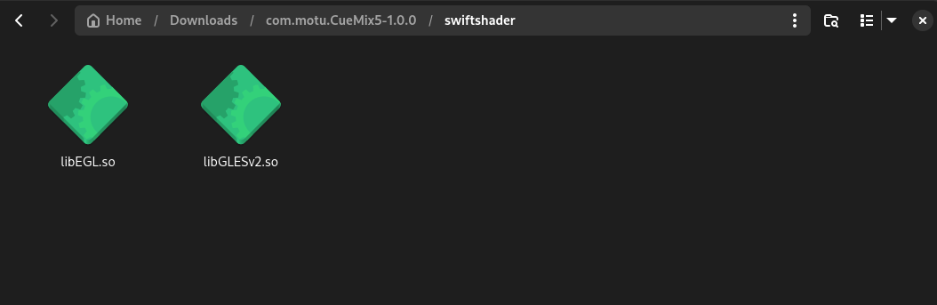

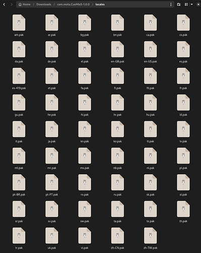

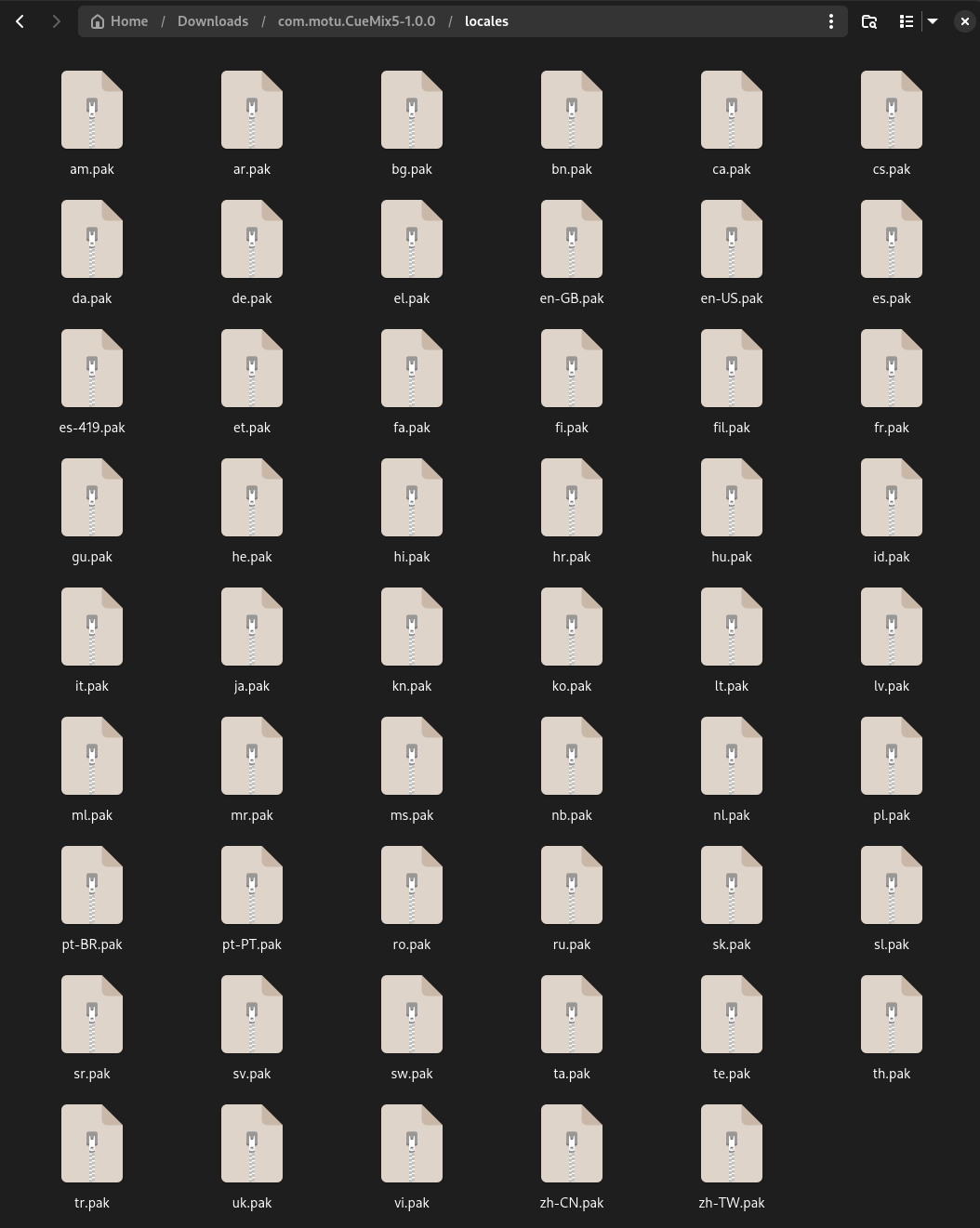

For clarity, here are the contents of the tarball that I’m trying to use. And again, on my Pop!_OS system, you just unpack the tarball and run com.motu.cuemix5 and the GUI pops right up.
