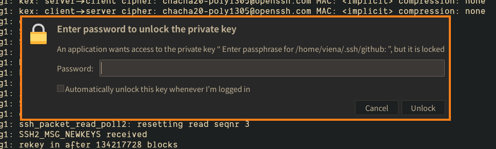

I managed to run your NixOS inside a virtual machine. I also got stuck for a brief period after debug1: Server accepts key, but then this window popped up:
After entering the password, I was able to access GitHub normally.

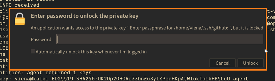

Hmm i ran it in vm too and this popped up.
but it was still stuck at server accepts key . after waiting for couple of mins i cancelled it and reran ssh -T git@github.com and this time neither the gui pops up asking for password nor is auth successful like it still hangs . and i can see 2 ssh-add in btop .
I stopped vm and re ran it , didn’t know my ssh key would persist , i reran ssh -T git@github.com and it still seems to hang . even the gui does not pops up .
TLDR : password prompt only pops up when running ssh -vT git@github.com for first time . Even after entering password , it seems to hang ? *unless I entered wrong password and the gui then never popped up again ?. And after that no matter how many times i try, gui doesn’t pops up .
EDIT: I entered incorrect password , this time it works in vm . so there is certainly somethign wrong with my hosts as it works flawlessly in vm

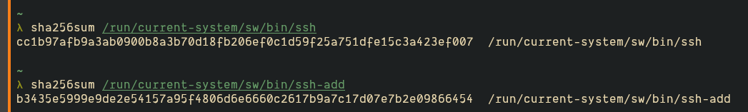

If it failed in the VM for you as well, I’m suddenly starting to wonder if some file in your nix store might be corrupted. (The VM tries to reuse the host’s /nix/store as possible, and I actually noticed a corrupted store at one of my machines yesterday.)
Of course, this is just my guess, and I’m not sure how to verify it. Will this be helpful?
