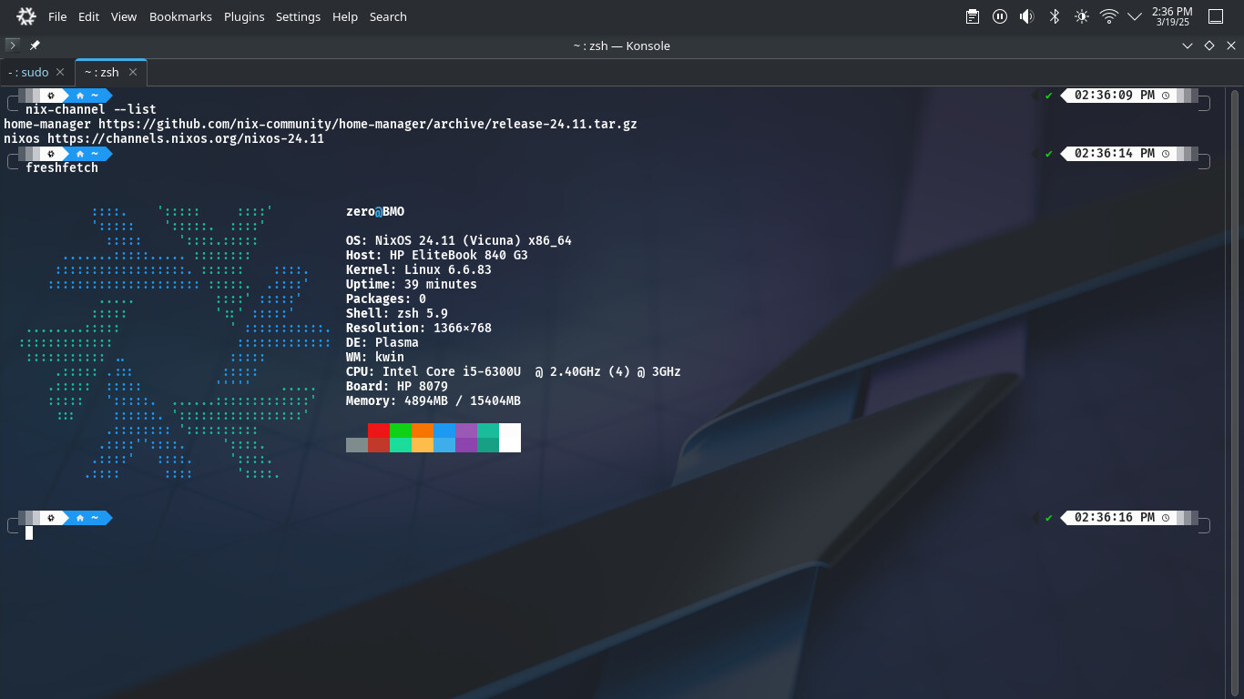

Now I am facing a weird issue, I had the 24.05 ISO from which I installed the system. Right now I am on 24.11.
The issue I am facing is my neovim is stuck on version 9.5 I use astroNvim and that requires me to have version 10 +, now idk what’s going on here.
The nix-repo shows that the neovim for 24.11 channel is 10.2, that’s why I upgraded from 24.05 but the neovim isn’t getting updated to the latest version.

Hi,
No I didn’t install neovim with nix-env
╰─ nix-env -q                                                                                                                                                       ─╯
home-manager-path
╰─ which nvim                                                                                                                                                       ─╯
/home/zero/.nix-profile/bin/nvim

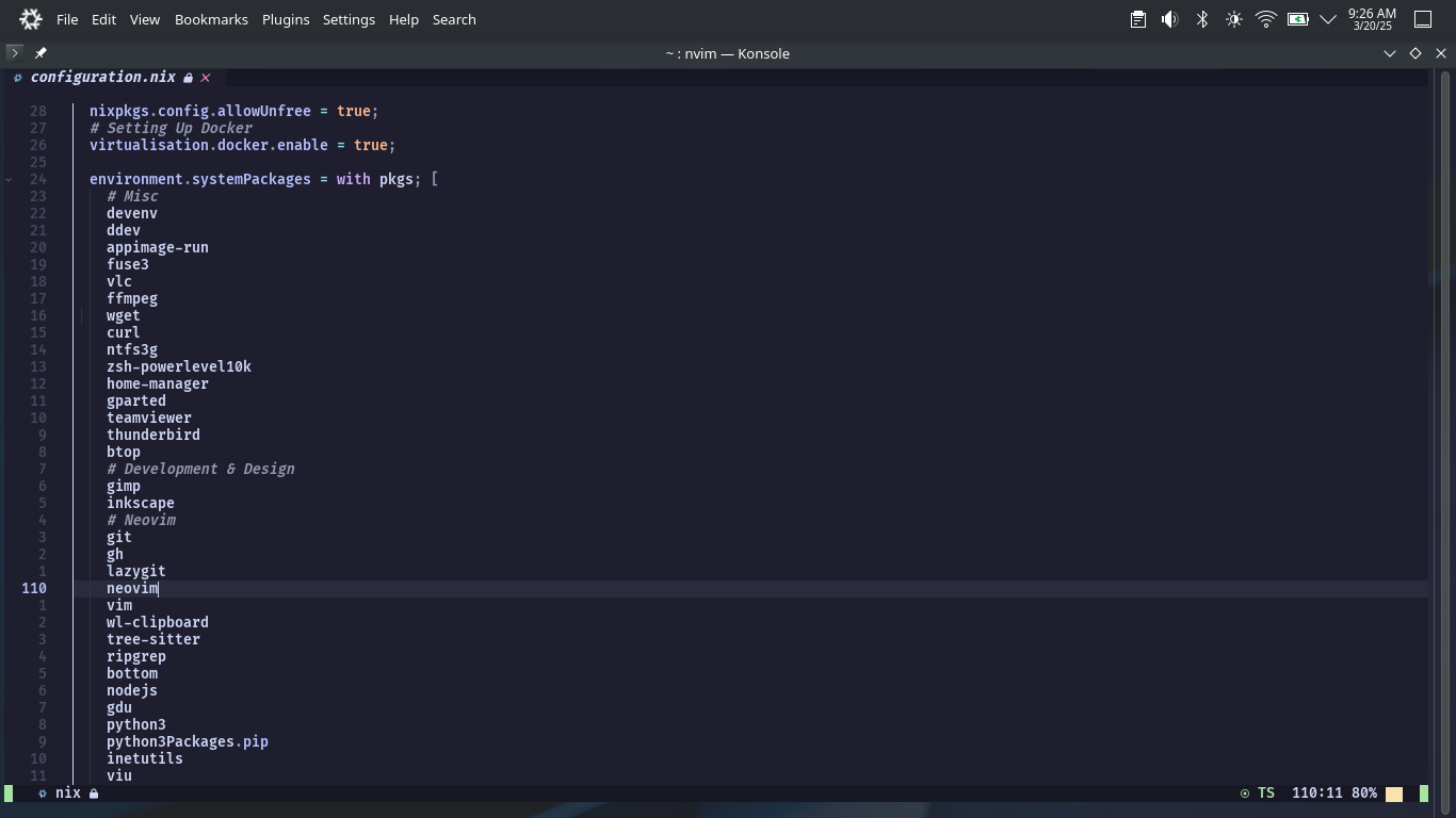

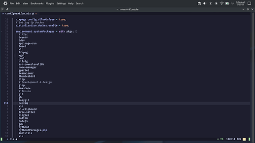

it’s in the /etc/nixos/configuration.nix
