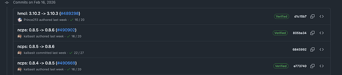

There haven’t been any merged updates for five days.
Maybe something’s wrong with the CI/CD?

I mean that the latest commit that got merged into this branch was six days ago.

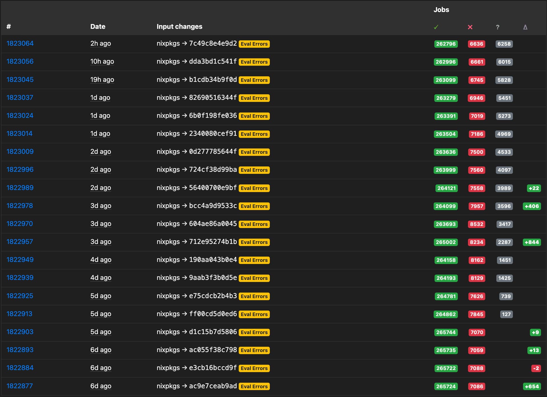

I found this thread because I was similarly searching for why a PR that had made it to all other channels (including nixos-*) was still missing from nixpkgs-unstable. There might be a problem with darwin builds in the CI pipeline… Hydra is showing an increasing number of jobs stuck in the “queued” state in nixpkgs-unstable starting ~5 days ago. The number of queued jobs increases with each run.
This seems to be unusual; paging back through this page shows that no Hydra job for nixpkgs-unstable has ended with jobs still in the queue in over a year (I only paged back through 2025, so maybe a similar situation happened even earlier).
A quick count of the most recent queued package list for nixpkgs-unstable shows that essentially all of these (>99%) are darwin builds. So whatever’s happening, it seems to only be impacting builds for macOS.

These counts are dynamic and update as the job progresses. If you look again (after a period of time) and compare a build number you will see the number of queued jobs falling and the number of successful and failed jobs increasing or staying the same (hopefully for failed builds).
This is why when paging back in time you see no queued jobs remaining. They either succeeded or failed.
For example job 1822949 is now complete.
