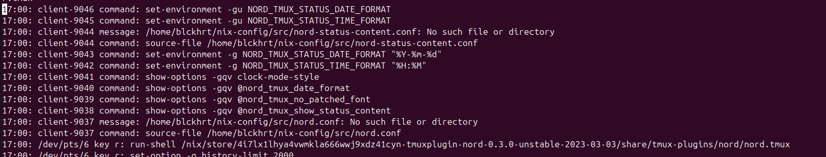

Once I source the config inside tmux, everything but the theme works. In regard to that, I looked at tmux messages using tmux-which-key and it mentions lack of a nord.conf file, even though it should be there. My config exists in ~/nix-config but I have no src directory there.

Your terminal output says this:
message: /home/blckhrt/nix-config/src/nord-status-content.conf: No such file or directory

Yeah, I checked with ripgrep for “.conf” and “nord”, no results came up in my tmux config for those other than ones in nonrelated files. I do not have an src dir in my config. Another bit of setup context, I use a makefile to run home-manager switch.
