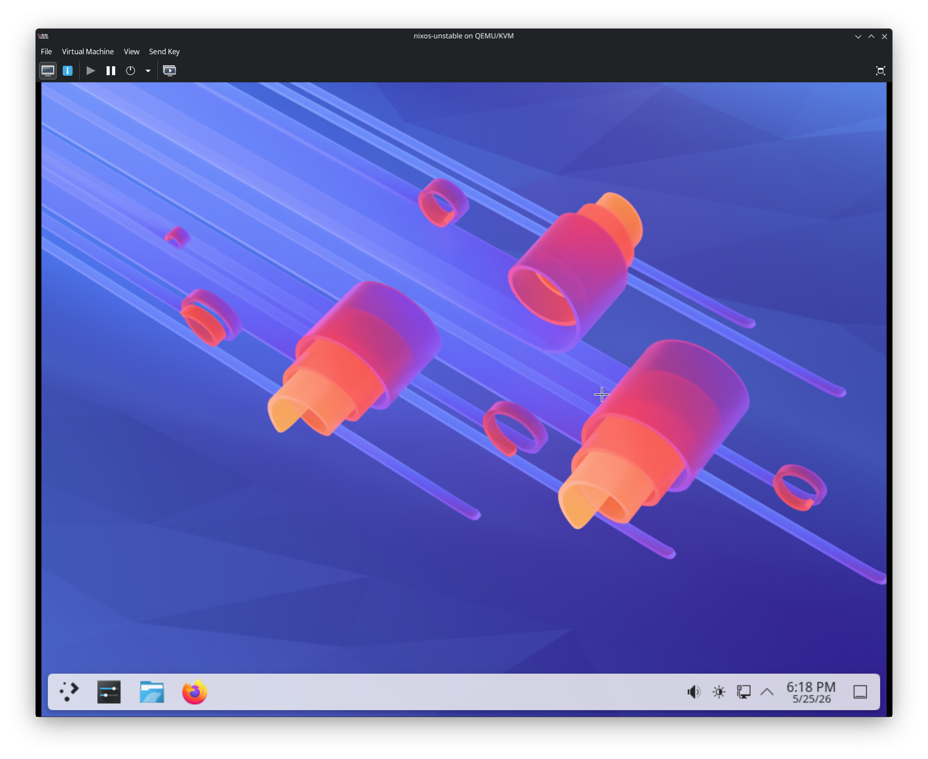

NixOS installs successfully on Mint’s VMM:

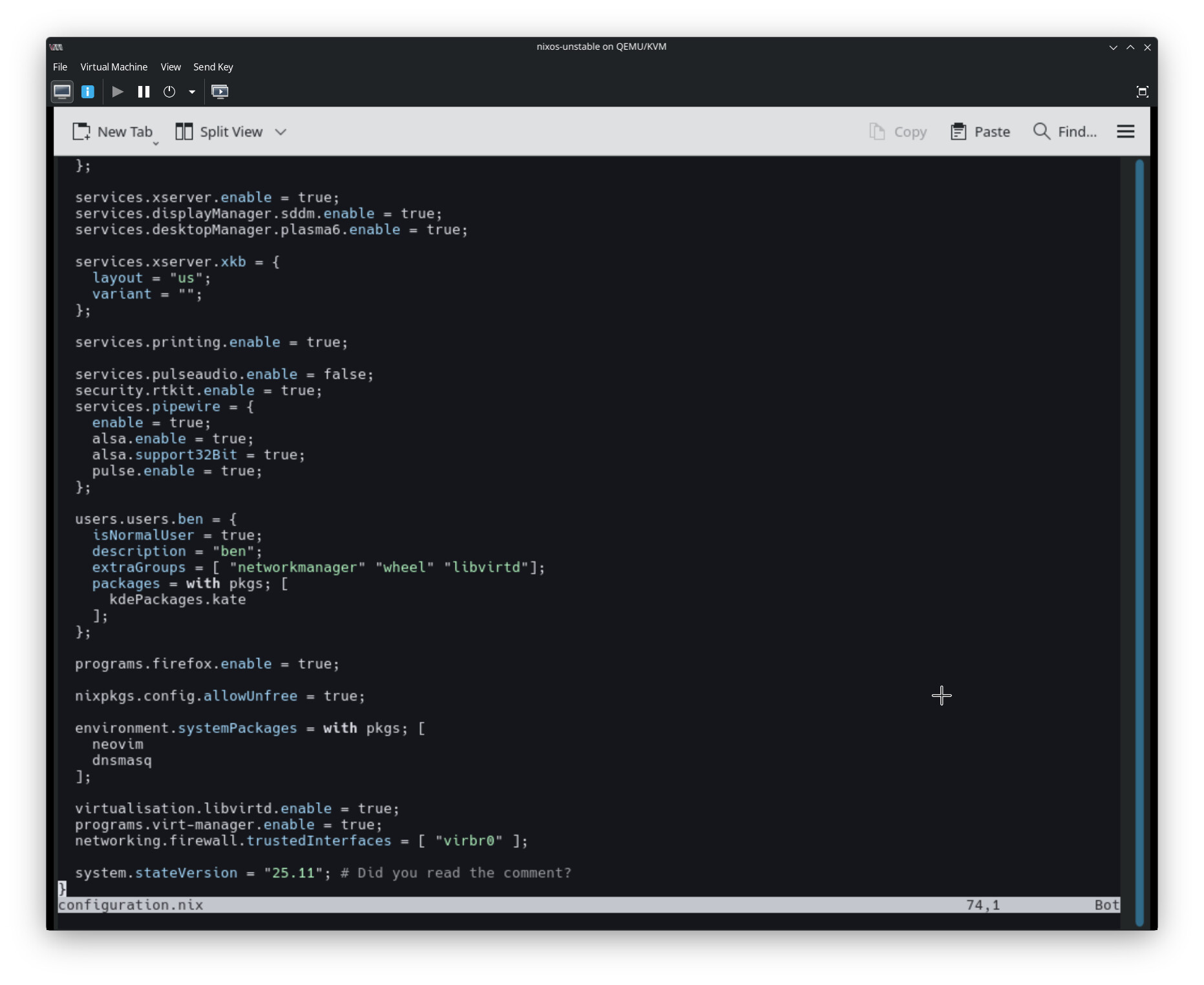

Then I followed this guide to install VMM on NixOS:

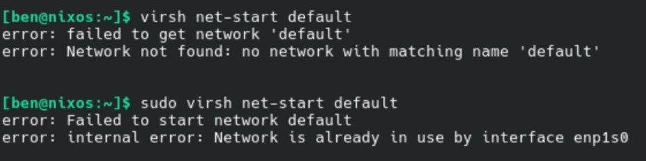

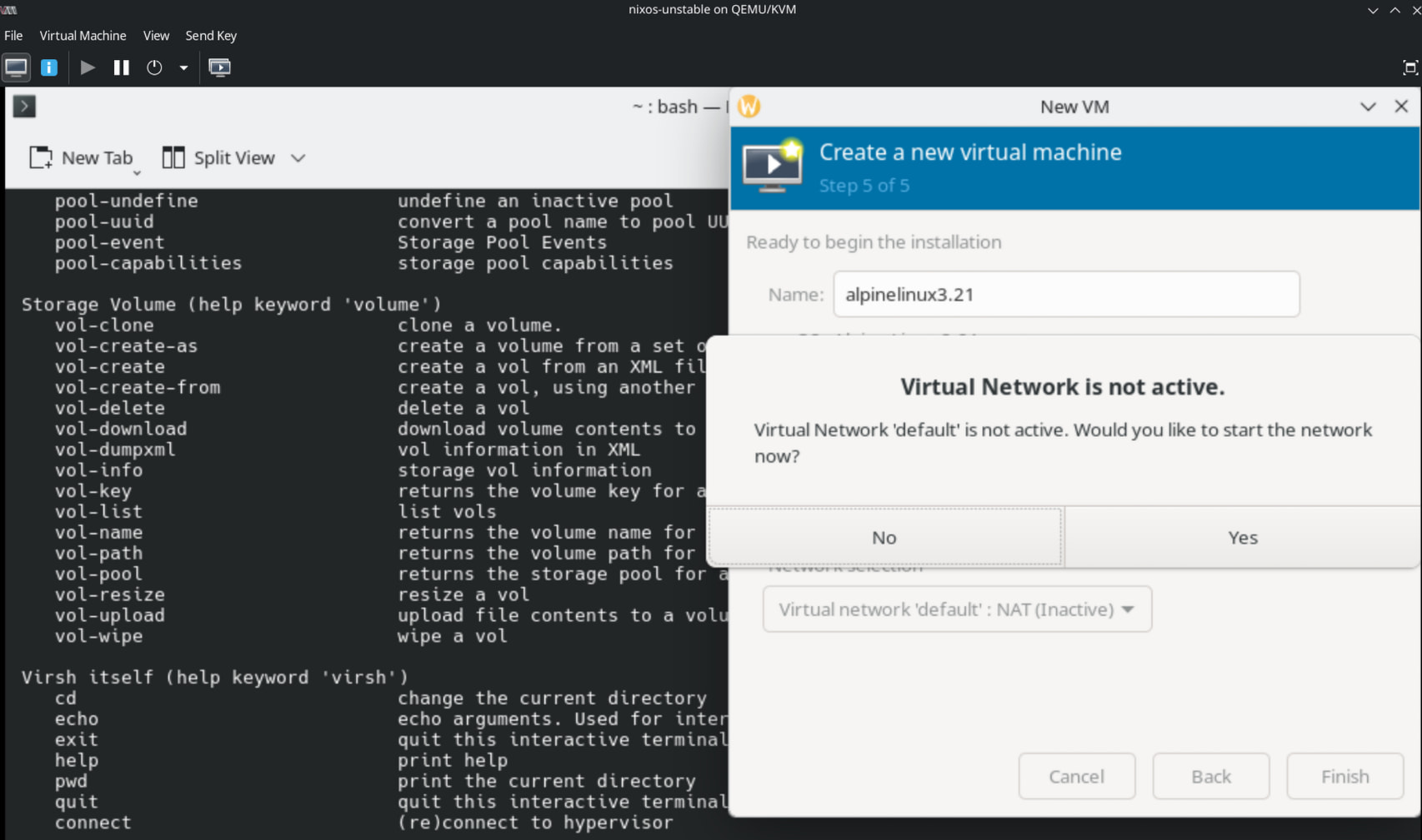

But virsh net-start default fails:
Anyway, when I open VMM, shows as QEMU/KVM connected:

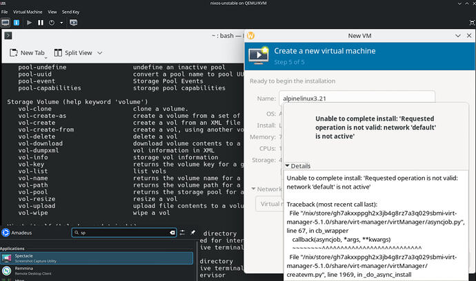

But when I proceed to install Alpine, I get an error:
Any ideas how can I fix these problem?
PS: Is there a way to manage virsh (make it auto start default) via configuration.nix?
Not sure about VMM specifically (edit: do you just mean virt-manager?) but when I was figuring out how to use libvirt, the key turned out to be to add -c qemu:///system to virsh commands and such. I’ve written a more detailed guide here in case that’s helpful.

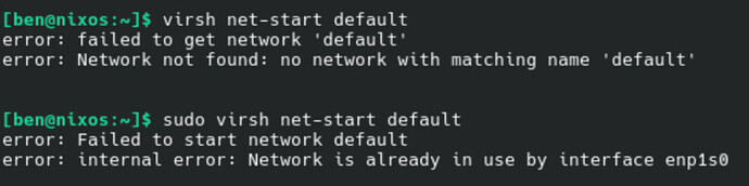

I am still getting the same error:
$ virsh -c qemu:///system net-start default
error: Faailed to start network default
error: internal error: Network is already in use by interface enp1s0
  • Running virsh -c qemu:///system net-start default on a host NixOS environment works.
  • Running virsh -c qemu:///system net-start default on a a NixOS environment that itself runs in a VMM fails.
That is because the default network in libvirt (and thus, virt-manager) is 192.168.122.x/24. In the guest OS, it is already your primary network, so it cannot be used (error: internal error: Network is already in use by interface enp1s0). One way to change it would be to edit connection details, remove the default network and create a new one with different IPs. If you want to have something declarative, I’m affraid there is not much network related settings in configuration, but you can create new xml in /etc/libvirt/networks/ and use systemd service to replace default network.
Thanks! A custom network with CIDR range 172.16.0.0/24 worked.
PS: Looks like it’s not necessary to run the virsh commands as VMM can autostart the network on boot.
