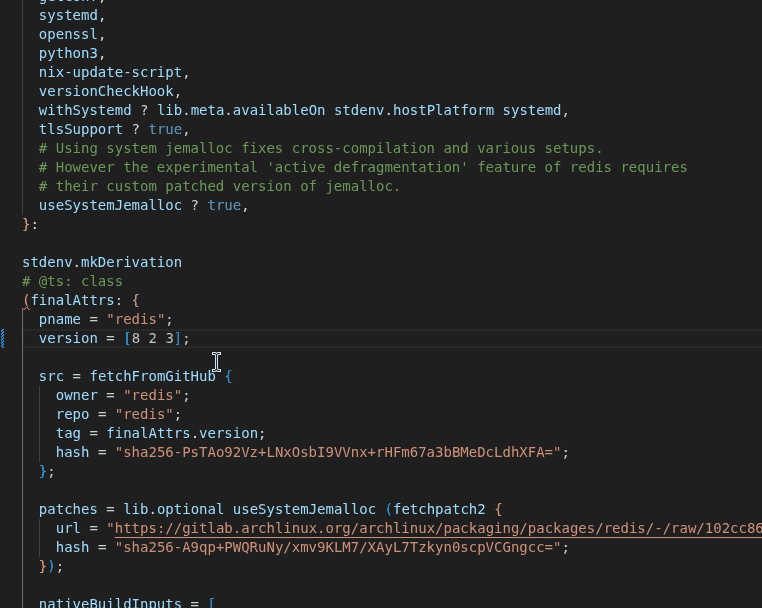

Kooha-2026-03-10-08-38-54_2x
How it works: instead of building a new checker for Nix, it maps tree-sitter-nix’s AST directly to TypeScript AST nodes. The standard TS binder, type checker and LSP work almost unchanged – they never know they’re looking at Nix.

It actually already has both an LSP and caching, since it piggybacks on TypeScript (added a gif to the original post, take a look!)
