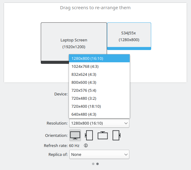

Ultra WQHD Monitor not working with kde or xfce
I bought a monitor that I haven’t been able to get working with nixos. It works with my mac computer. To troubleshot I have check the display dialogs. The monitor shows up but the correct resolutions are not there.
When I check the xorg log this is what I see after plugging in the monitor.

There are some warnings but I think they are for the laptop display, not the new monitor. When the monitor is plugged in it is still blank. Any thoughts on what else I can do?

But I still have the same issue. This monitor is connected using a usbc to hdmi cable.
