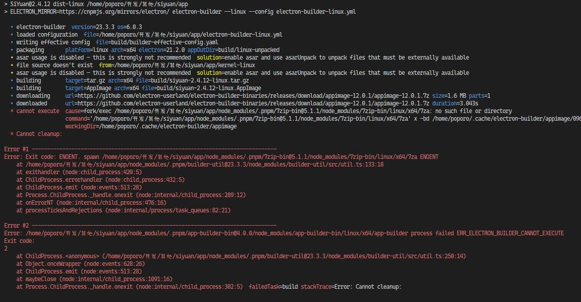

Unable to compile node/pnpm project under nixos nix-shell
with cmd : pnpm run dist-linux
i was compiled successfully on windows and wsl-ubuntu
my shell.nix:
Project Name:siyuan

According to your logs, the package vendors a copy of 7z
. This will have an interpreter that is incompatible with nix’ fhs env.
You can patchelf that binary, it’s the one in comand=
in your log.
Note that this is a very common problem when dealing with npm. Lots of people seem to think it’s ok to bundle random executables with their javascript.
See also Packaging/Binaries - NixOS Wiki
