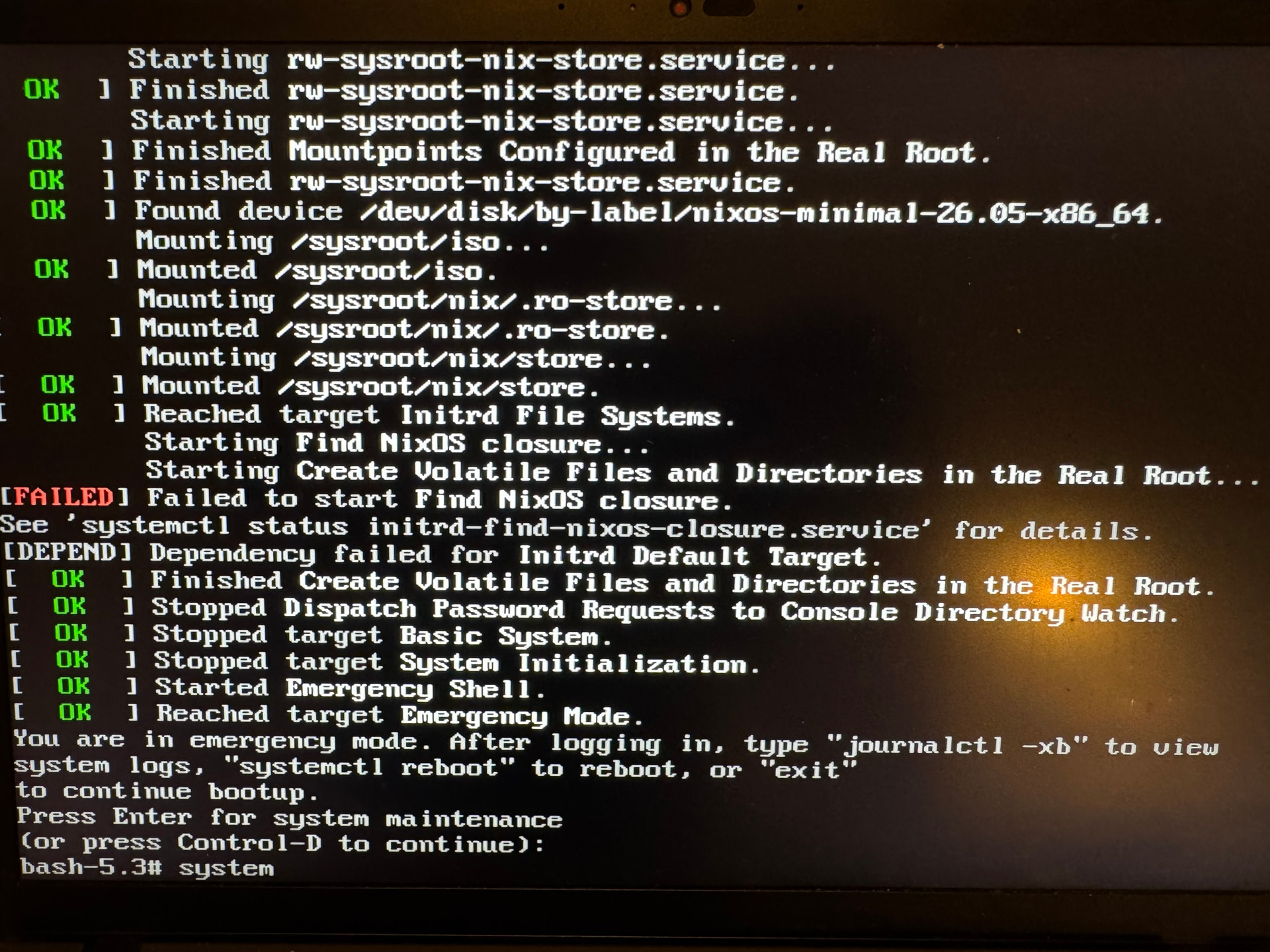

Yesterday I wanted to install NixOS on my Thinkpad p14s AMD Gen 5 edition, so downloaded the graphical installation iso, put it on my Ventoy stick and tried to boot.
This resulted in an error in Find NixOS closure, looked it up, appears to be a problem with Ventoy.

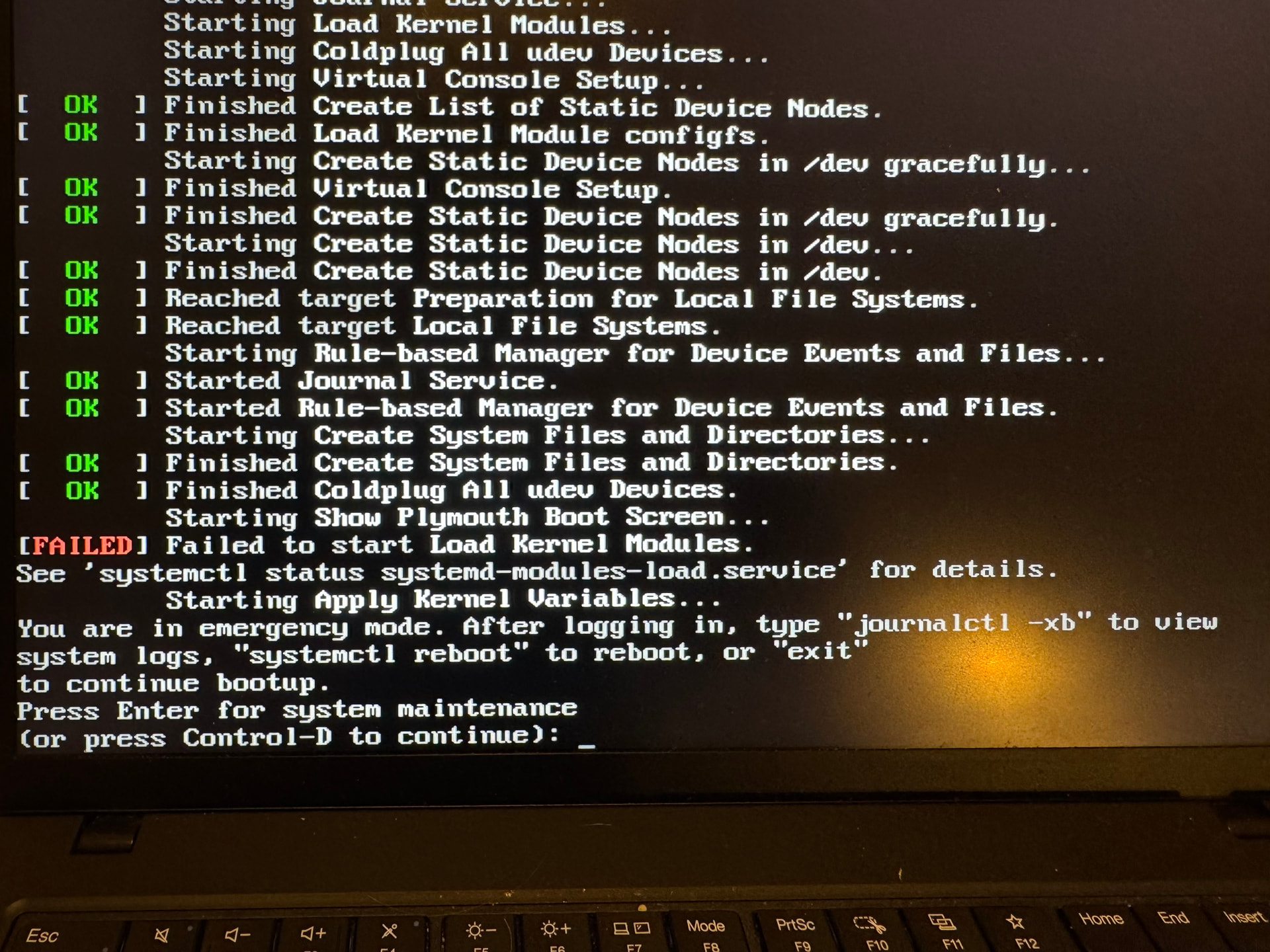

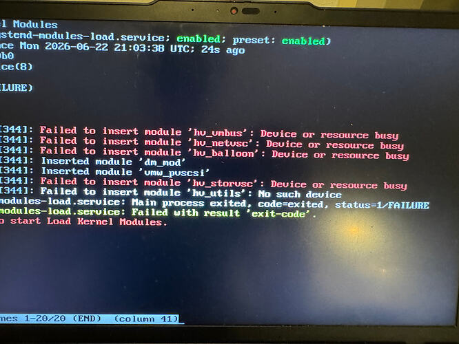

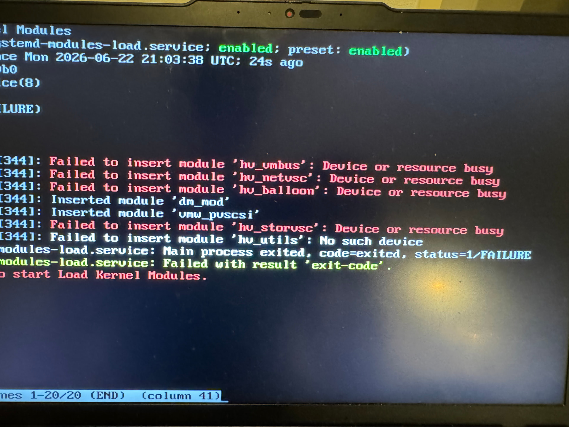

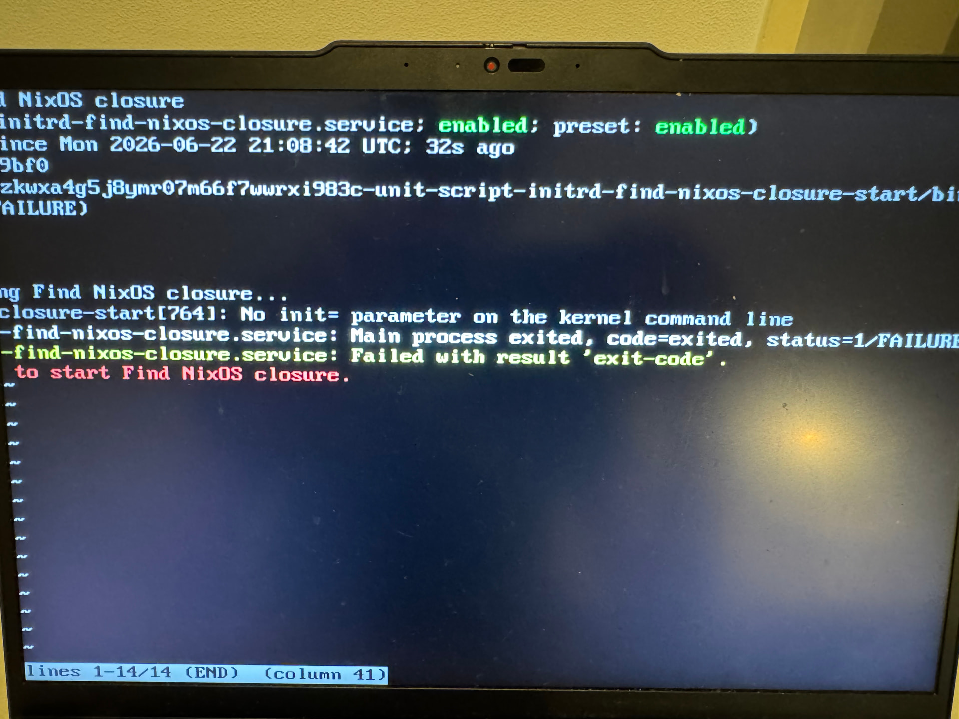

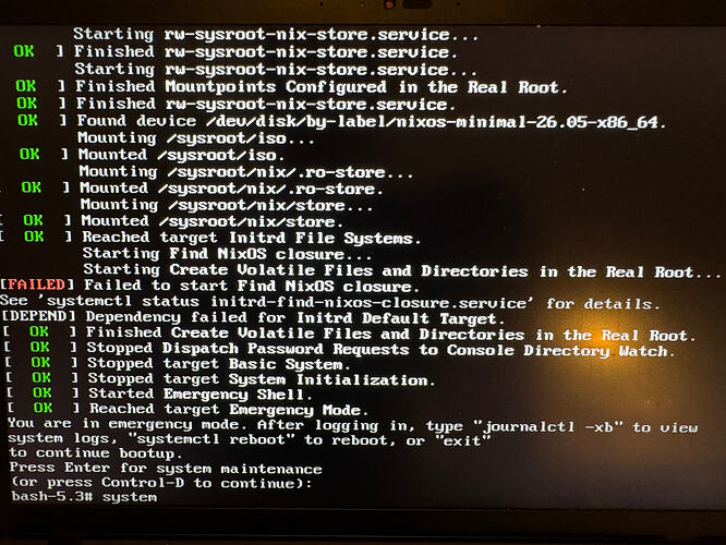

Thanks for replying, I have retried and made some pictures of the errors, the graphical and minimal iso’s give me two different errors;
graphical:
And for the minimal installer

From looking at your photos, it seems like there might be some hardware incompatibility. Which is a bit odd, given that your cute thinkpad is pretty modern, and they are known to be linux friendly. If it is not reaching GRUB, I might try to tinker with the bios settings, to make sure your USB stick is in front of the line in the boot device order
My instinct might be to install something like Debian (or ugh, Ubuntu) on it to bifurcate the problem space. I think, but I don’t know, that it is possible to even use another linux to bootstrap into NixOS
This error doesn’t make sense. The NixOS ISO would never boot without an init= parameter. This indicates an altered boot loader config, like you flashed it with Rufus not in dd mode or something along those lines.
