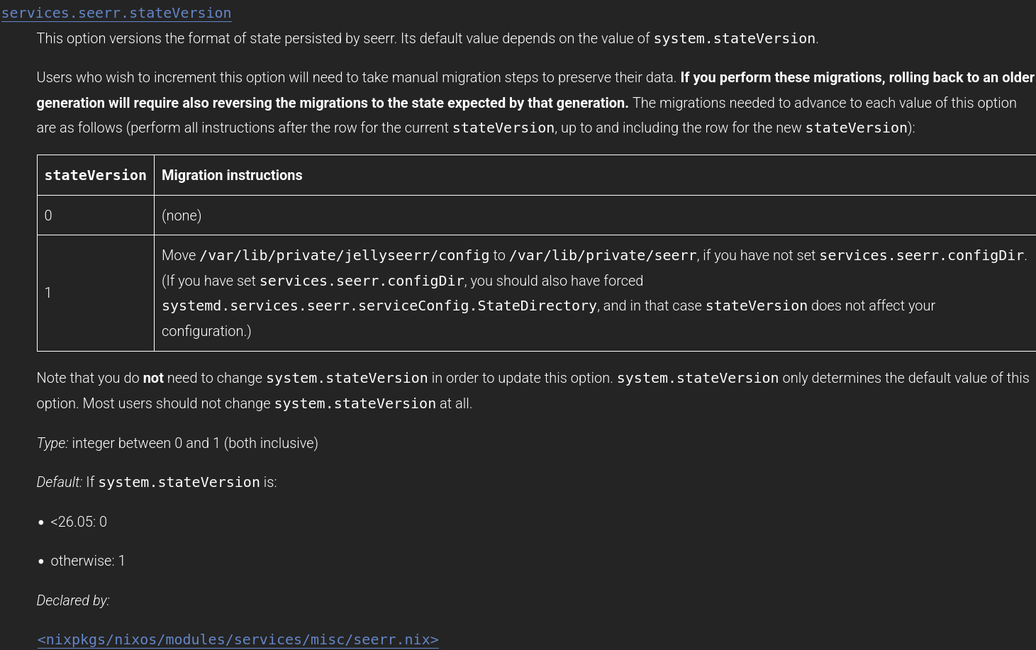

which is just a huge misrepresentation. See https://github.com/NixOS/nixpkgs/pull/509450 for the sort of docs I think stateVersion ought to have.

I don’t really see the point in having this thread another time. The current situation sucks, yes, but we have good proposals for fixing it. @rhendric 's PR is kind of the last possible word on the topic of stateVersion.
Once/if it lands, and other modules adopt the same pattern, the issue will already be largely resolved through better documentation, and long-term removal becomes much more feasible. The only thing that’s left to do is actual work.
