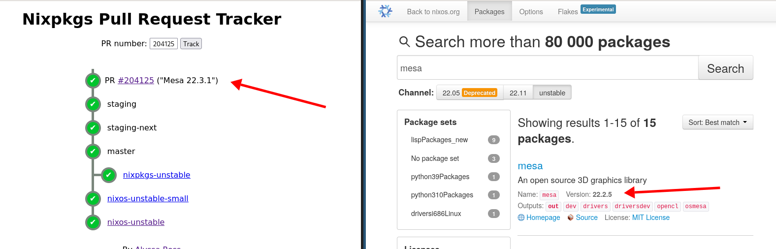

See also @qyliss 's PR tracker: Nixpkgs PR #204125 ("Mesa 22.3.1") progress
Oh the PR tracker is helpful! It’s still hard to tell when it will be done though based on current test running prrogress. Days? Weeks?
So it looks like the PR Tracker is all green, but the package is still not showing up in the repo. Is there another step here?
Search isn’t literally searching the git repo–it’s an index that has to be updated. This means there’ll always be at least a little lag time between updates to the repo and what’s available in search.
It looks like it tries to update hourly, and that the automated updates started failing for unstable 3 days ago: Hourly import to Elasticsearch · NixOS/nixos-search@7abecfe · GitHub
The nixos-unstable channel finally got bumped after 3 days of build failures (see https://status.nixos.org).
The package index should get updated soon to reflect this.
Aha! Okay I now know where to monitor next. Thanks friends!
To be clear, though–the package itself should already be available in unstable.
Bam! I updated my flake and was able to install it successfully. Thank you!
