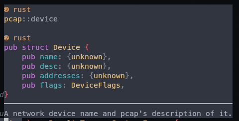

Using a nix shell breaks LSP in Neovim?
I’m trying to develop a Rust application, however, when I develop from within the Nix shell for my project (via. nix develop), my LSP within Neovim appears to sort-of break:

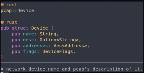

I’ve confirmed it works fine outside of the nix shell:
Is there any way to either:
  • Fix the issue so that the LSP from the development shell works fine; or
  • Use the system LSP from within the shell.
For reference, I’m using the oxalica/rust-overlay to provide the latest stable toolchain and my default dev shell is:
