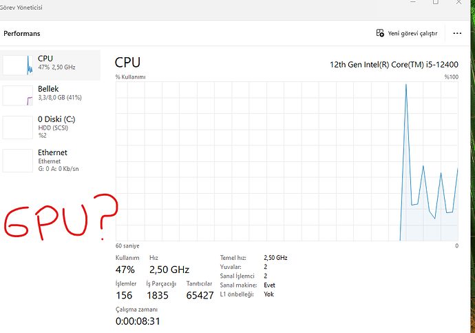

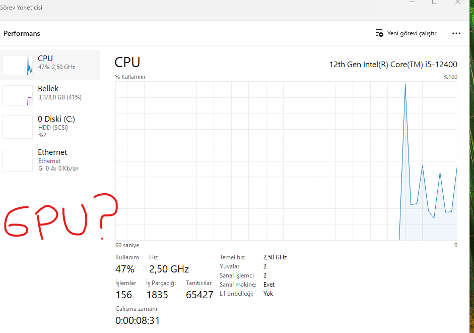

I installed win11 with virt-manager, added the video card as pci devices, did the driver installation and it’s done. The only problem is that I can’t paste what I copied to Nixos into the win11 virtual machine. Before I connected an external video card there was no problem, with the video card this problem occurred.
How can I fix the problem, I’d appreciate your help.
