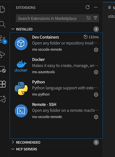

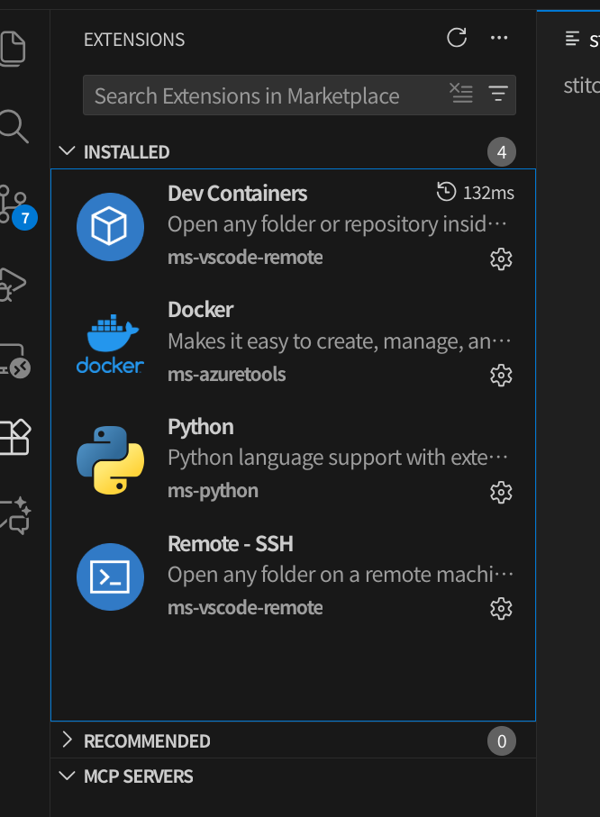

wow, looks like, this was the answer! Thanks a lot!
