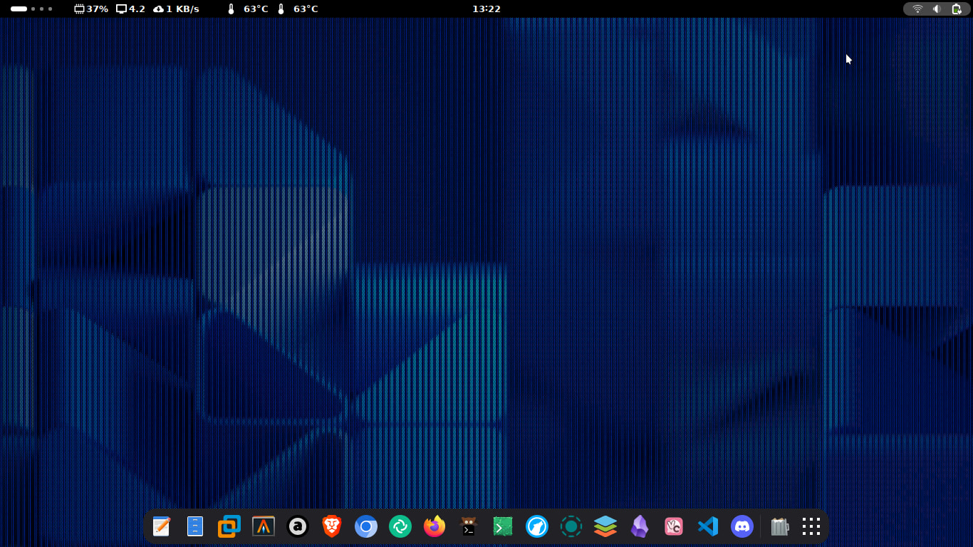

Wallpaper glitching and broken image thumbnails
Hello.

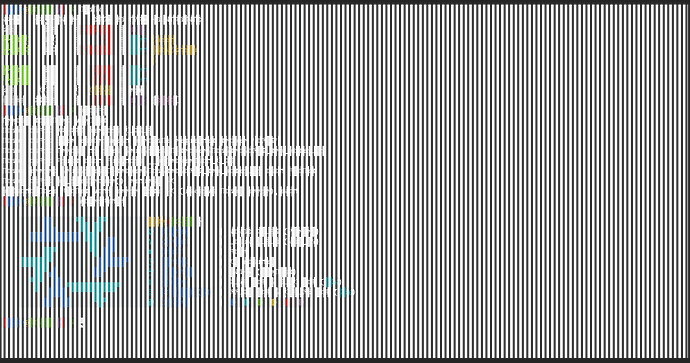

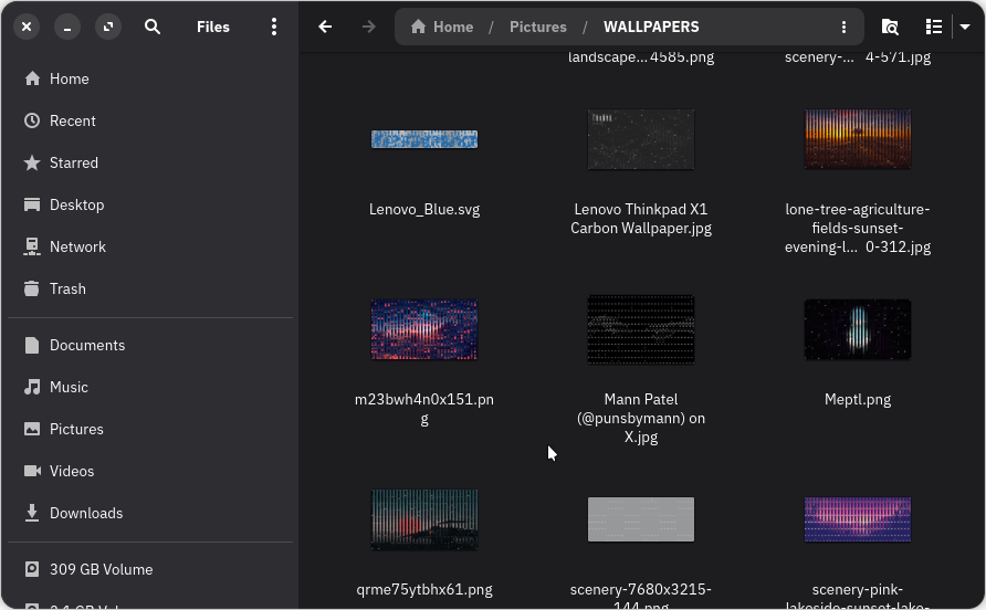

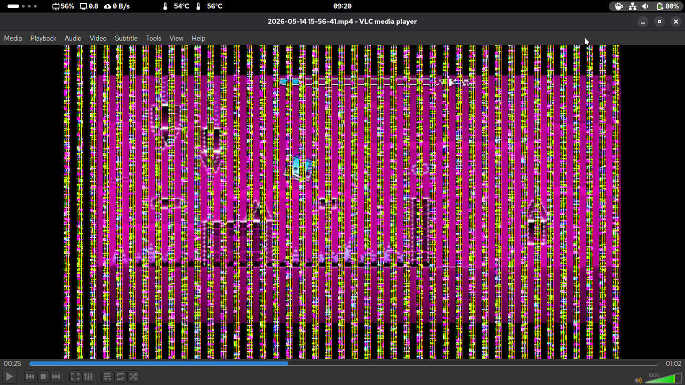

I had issues with wallpaper on gnome, image thumbnails on nautilus, and broken recording on obs.
Screenshot:
Broken wallpapers and thumbnails:

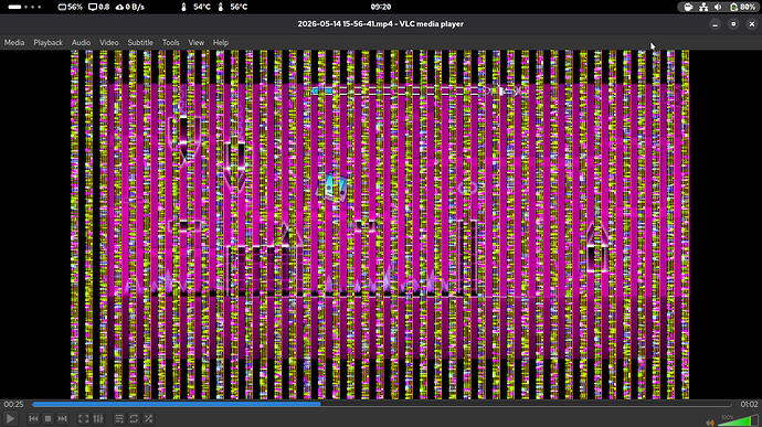

Broken Recording
This happened when after rebuilding, and somehow VAAPI just won’t work even though the driver is correct, I also checked each wallpaper in image viewer and it shows fine. but these problem does not apply in arch linux.

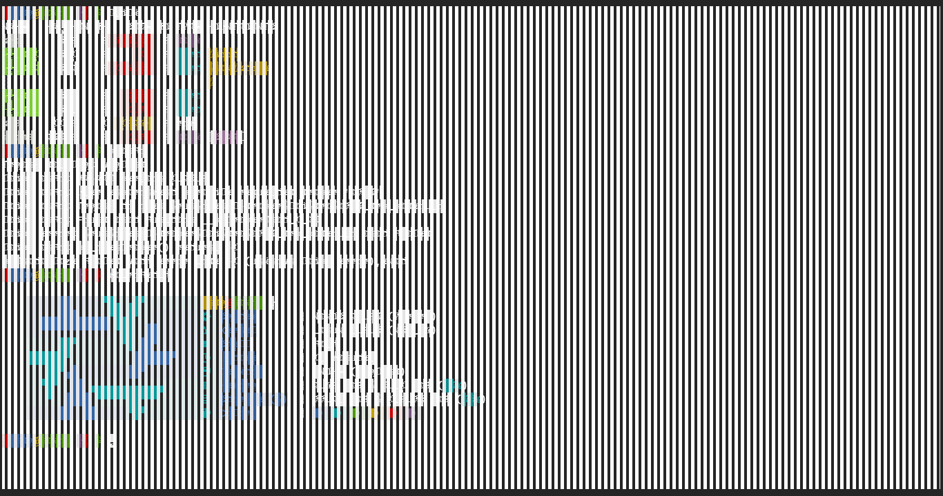

I tried it and it didn’t work, but when I ran it on X11 instead of Wayland, it worked—though the glitch was still there. My Kitty terminal also had the same issue on both X11 and Wayland.

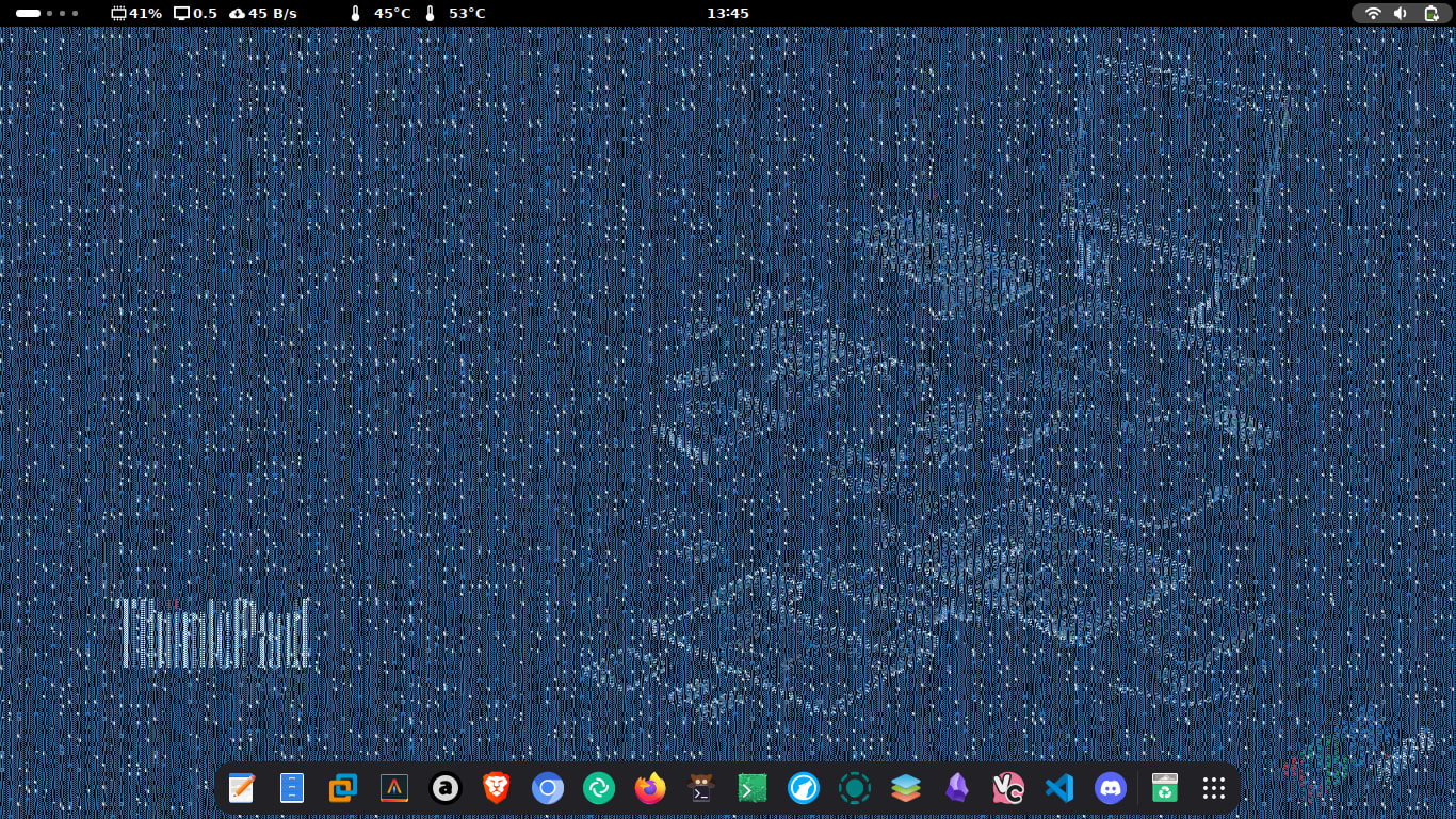

Okay, after a few days I figured out the problem. When I updated my Arch Linux, I realized that my Arch was also affected, so I tried rolling back a package called “mesa” and it worked without any issues. But I haven’t tried it on NixOS yet.
The version of Mesa I’m currently using is: mesa 1:26.0.6-1
