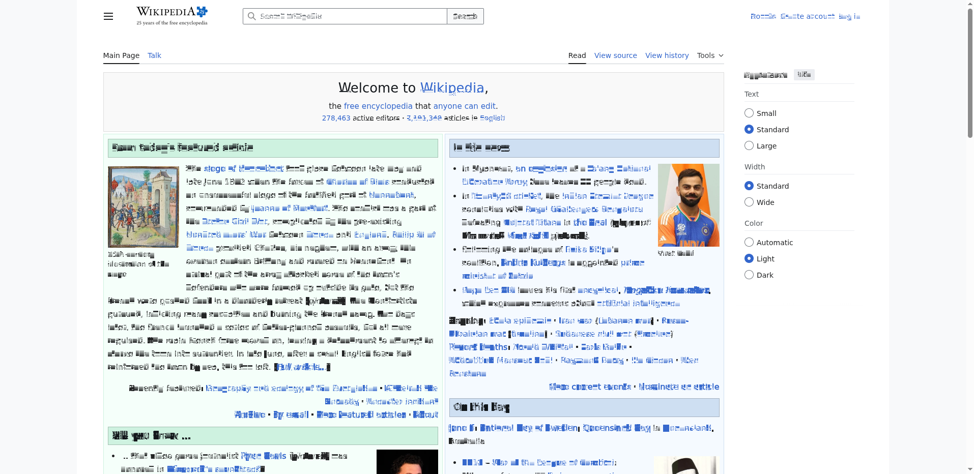

26.05, Brave on Sway - something is seriously messed up with the font rendering
I just upgraded to NixOS 26.05 Yarara, and I’m using Brave Browser on Sway, and I absolutely cannot read most of the text of websites and the browser chrome itself. Most of the text is being covered by random lines and boxes, as shown below. Very bizarre.

It does not seem to matter if I use a Classic, GTK, or Qt Brave appearance.
Ah, okay, the issue is resolved completely; I simply disabled GPU rasterization through chrome://flags/#enable-gpu-rasterization.
A Kubuntu issue that seems to describe the exact same issue
