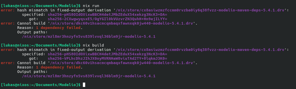

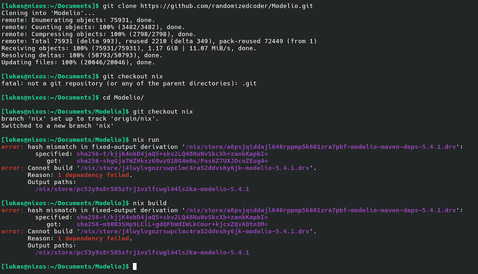

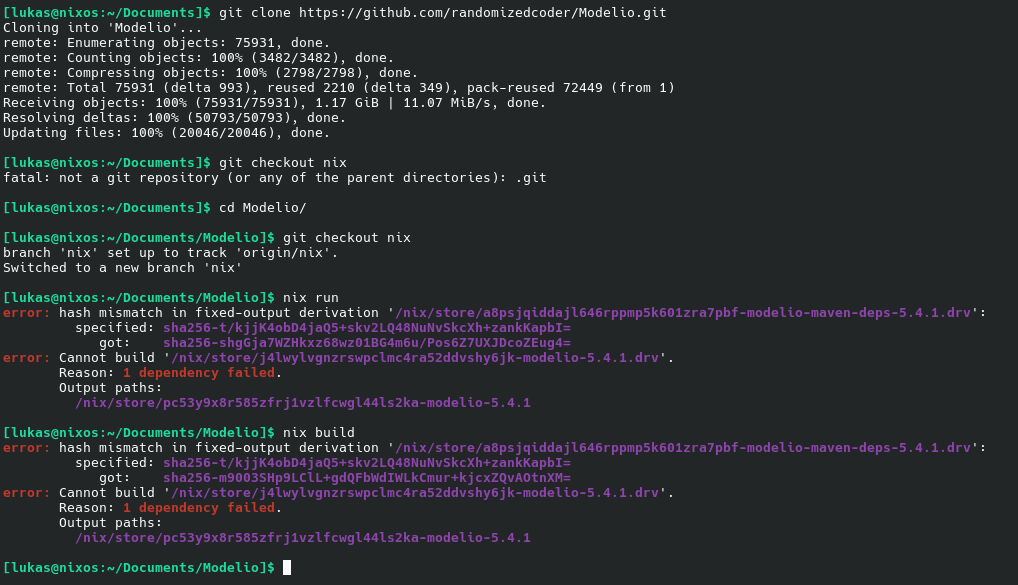

I get this error:
What did i do?
Enabled flakes in configuration.nix like it is described here: Enabling NixOS with Flakes | NixOS & Flakes Book
Forked your github repository → checked out the branch “nix”
→ run “nix run”
→ run “nix build”
As another question why are you using a flake? (I just started with flakes today and am working through the course i linked above)
How about donating the $50 for the Nix Foundation?
I take it that you want to divert the 50$ to the Nix Foundation is that assumption correct? (i would donate it here: NixOS - Open Collective)
You did nothing wrong, this is just maven being maven, paired with a grain of “this is how fixed output derivations work”.
Maybe basing the expression on maven.buildMavenPackage might be more succesfull, maybe the way how the maven project is written, simply doesn’t allow for using a FOD without patching.
Doh! Sorry. Please try again.
Source is now pinned.
Thanks for having a look.
I still have the problem
I cloned the repo fresh as i first thought that maybe this is the problem.

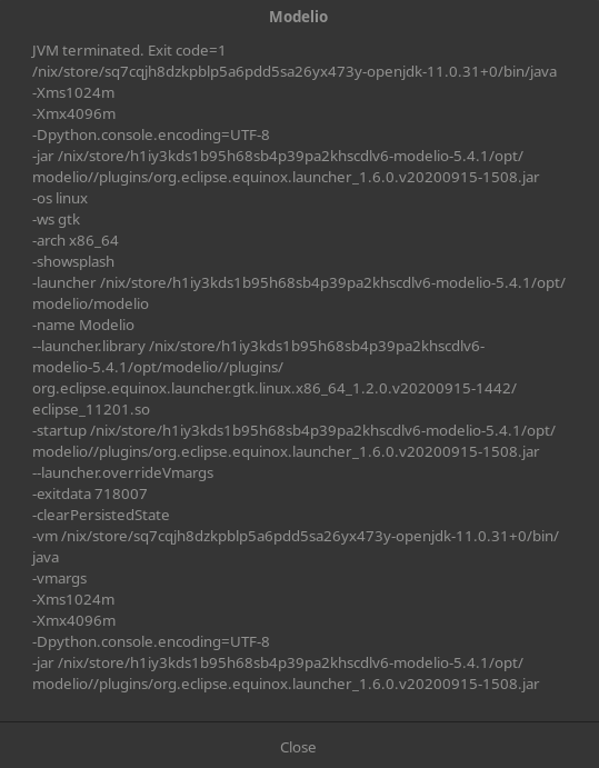

i copied your code in a “flake.nix” file and tried running it with “nix run” it instantly crashes.
Interesting, does nix build && ./result/bin/modelio also crash? And could you provide the full error logs if possible?

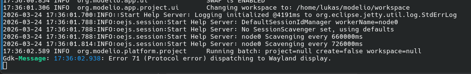

yes it also crashes the log:
logs

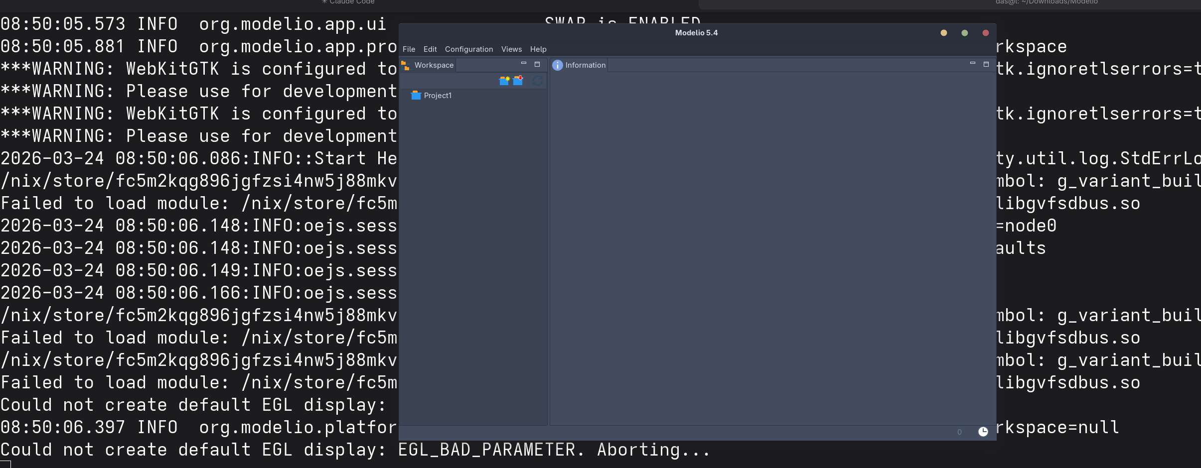

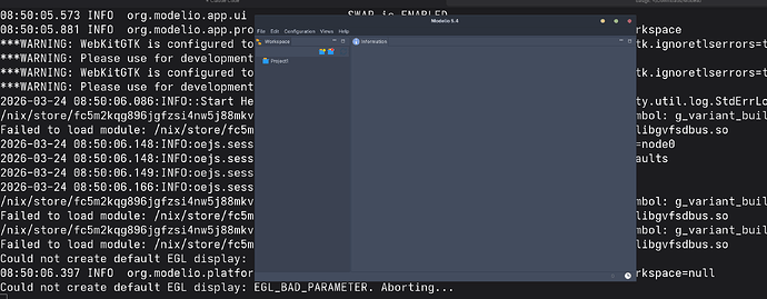

Gdk-Message: 17:39:39.626: Error 71 (Protocol error) dispatching to Wayland display.
Interesting that it works for me because I’m also on wayland.
Anyways can you try this out? Might be able to make it work by forcing X11
            makeWrapper $out/opt/modelio/modelio $out/bin/modelio \
              --prefix PATH : "${pkgs.openjdk11}/bin" \
              --set JAVA_HOME "${pkgs.openjdk11.home}" \
              --set GDK_BACKEND "x11" \
              --set SWT_GTK3 "1" \
              --set SWT_WEBKIT2 "1" \
              --set UBUNTU_MENUPROXY "0" \
              --set LIBOVERLAY_SCROLLBAR "0" \
              --prefix GIO_EXTRA_MODULES : "${pkgs.glib-networking}/lib/gio/modules" \

It looks like it is working.
Hell yeah. Glad I could be of help.
Also if anybody wants to go the extra mile and upstream it, then you are more than welcome to.
(as technically the bounty is still unfulfilled going by original wording :wink: )
