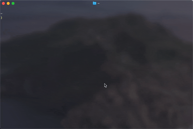

Yes, if the video isn’t loading you can try the link mentioned, or alternatively since it’s such a small video here it is as a GIF (maybe I should have done this from the beginning):
Demo video
