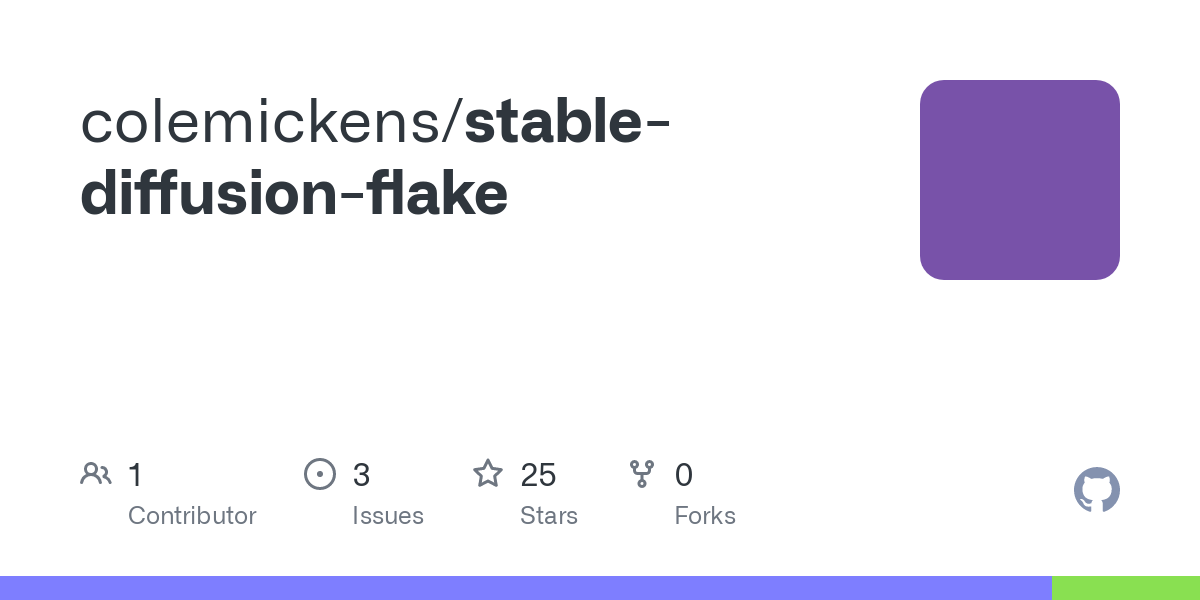

:wave: :wave: It’s a WIP, but there’s already a working mode that gets the “full” Stable Diffusion up and running with the “sd-web-ui” interface, assuming you have it cloned and the model installed to the right directory.
Please see the README for details, usage, wip notes, and credits.
call for help: to make this less hacky and more reliable, there are more python packages that need attention or initial packaging. If you have some spare time and want to take a whack, again see the README.

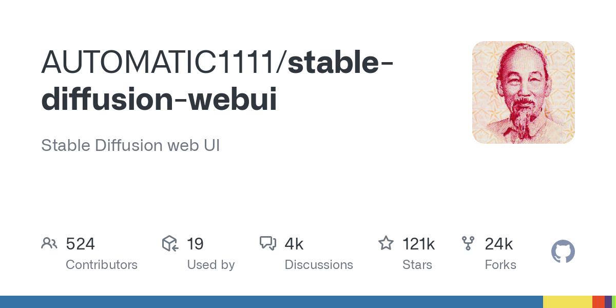

I haven’t really had a chance to de-pip and add more nix derivations, but I did find out that what I had works with the AUTOMATIC1111 web ui fork as well:
I’ve been able to do img2img, use some upscalers, and apparently this fork supports 4GB GPU models too… so this might be more accessible to a lot more folks.
