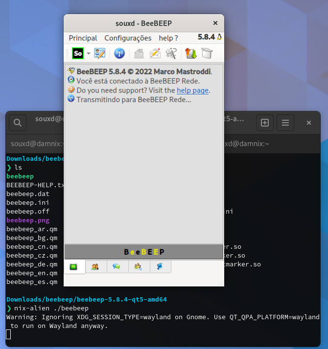

Is your X11 otherwise working? Can you start xeyes? If not do you have XAUTHORITY env set?
Yes i can start xeyes and qt xcb apps through Xwayland.
