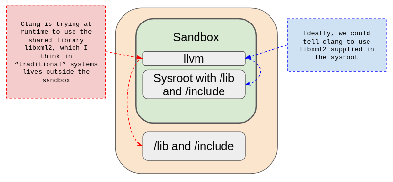

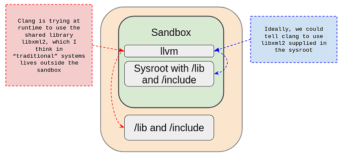

I have just managed to get Bazel to run go race tests on NixOS, and have sent the rules_go a PR
Issue: LD_LIBRARY_PATH cannot be set within the sandbox · Issue #4360 · bazel-contrib/rules_go · GitHub
Pull request: impure_env by randomizedcoder · Pull Request #4361 · bazel-contrib/rules_go · GitHub
… Bazel is a lot less hermetic an Nix :wink:
In this repo, there’s an example of a very simple go program with a race test, and this repo uses Nix to create a sysroot, that gets pulled into the Bazel sandbox, and can then perform the necessary linking using llvm’s ld.lld.
