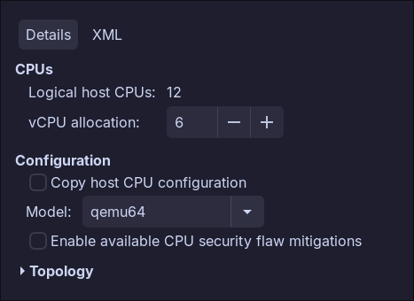

You can do most steps of the VM creation as you would do normally, except for the CPU configuration. I had my host machine hard crash without even journald logs without this. I’m suspecting some thermal issue, which doesn’t really make sense, but I digress.
The following configuration worked for me. I think the primary thing that matters is the CPU core count, but not using host-passthrough may also be part of it.

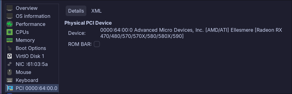

Once the machine is created, attach ONLY the PCIe graphics card device. Don’t add the USB ports or HDMI audio. I’ve found this to cause problems.
I think disabling ROM BAR also matters. It’s the option that has been in place ever since I’ve gotten the VM running stable, at least.
