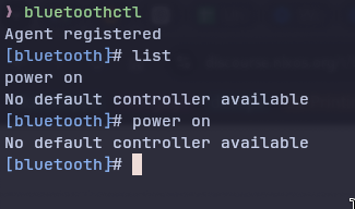

Bluetooth no default controller available
I have been trying to setup bluetooth on my PC running a asus motherboard with an intel i7 chip. When i check bluetoothctl show i get No default controller available.

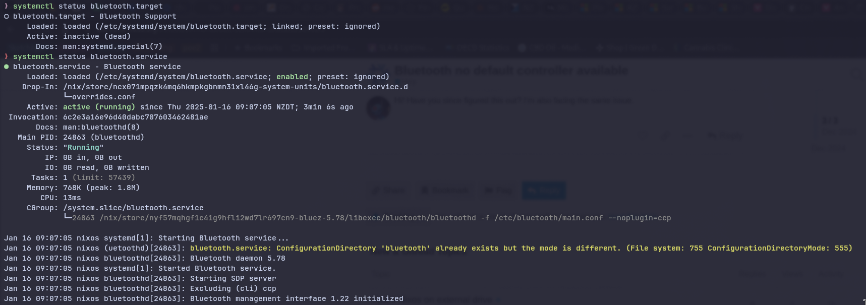

Upon further investigation journalctl returns the following
been trying to setup bluetooth for a while with no luck this is what i get when i check journalctl
> journalctl -xe | grep bluetooth
Nov 12 03:19:52 nexus .gnome-control-[2936]: Failed to register object: An object is already exported for the interface org.bluez.Agent1 at /org/gnome/bluetooth/settings
░░ Subject: A start job for unit bluetooth.service has begun execution
░░ A start job for unit bluetooth.service has begun execution.
Nov 12 03:19:57 nexus (uetoothd)[3131]: bluetooth.service: ConfigurationDirectory 'bluetooth' already exists but the mode is different. (File system: 755 ConfigurationDirectoryMode: 555)
Nov 12 03:19:57 nexus bluetoothd[3131]: Bluetooth daemon 5.78
░░ Subject: A start job for unit bluetooth.service has finished successfully
░░ A start job for unit bluetooth.service has finished successfully.
Nov 12 03:19:57 nexus bluetoothd[3131]: Starting SDP server
Nov 12 03:19:57 nexus bluetoothd[3131]: src/plugin.c:init_plugin() System does not support bap plugin
Nov 12 03:19:57 nexus bluetoothd[3131]: src/plugin.c:init_plugin() System does not support bass plugin
Nov 12 03:19:57 nexus bluetoothd[3131]: src/plugin.c:init_plugin() System does not support mcp plugin
Nov 12 03:19:57 nexus bluetoothd[3131]: src/plugin.c:init_plugin() System does not support vcp plugin
Nov 12 03:19:57 nexus bluetoothd[3131]: profiles/audio/micp.c:micp_init() D-Bus experimental not enabled
Nov 12 03:19:57 nexus bluetoothd[3131]: src/plugin.c:init_plugin() System does not support micp plugin
Nov 12 03:19:57 nexus bluetoothd[3131]: src/plugin.c:init_plugin() System does not support ccp plugin
Nov 12 03:19:57 nexus bluetoothd[3131]: src/plugin.c:init_plugin() System does not support csip plugin
Nov 12 03:19:57 nexus bluetoothd[3131]: src/plugin.c:init_plugin() System does not support asha plugin
Nov 12 03:19:57 nexus bluetoothd[3131]: Bluetooth management interface 1.22 initializ

i checked lsmod and dmesg and the device seems to be recognized. but bluetoothctl is not seeing it
curious why you have to set this but that seems to be what the error is complaining about?

  systemd.services.bluetooth.serviceConfig.ConfigurationDirectoryMode = "755";
  services.blueman.enable = true;

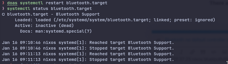

journalctl -a | grep bluetooth
Nov 22 16:57:56 nixos (uetoothd)[4379]: bluetooth.service: ConfigurationDirectory 'bluetooth' already exists but the mode is different. (File system: 755 ConfigurationDirectoryMode: 555)
Nov 22 16:57:56 nixos bluetoothd[4379]: Bluetooth daemon 5.75
Nov 22 16:57:56 nixos bluetoothd[4379]: Starting SDP server
Nov 22 16:57:56 nixos bluetoothd[4379]: Excluding (cli) ccp
Nov 22 16:57:56 nixos bluetoothd[4379]: Bluetooth management interface 1.22 initialized
Nov 22 23:34:05 nixos bluetoothd[4379]: Terminating
Nov 22 23:34:05 nixos bluetoothd[4379]: Stopping SDP server
Nov 22 23:34:05 nixos bluetoothd[4379]: Exit
Nov 22 23:34:05 nixos systemd[1]: bluetooth.service: Deactivated successfully.
Nov 23 16:18:22 nixos (uetoothd)[4385]: bluetooth.service: ConfigurationDirectory 'bluetooth' already exists but the mode is different. (File system: 755 ConfigurationDirectoryMode: 555)
Nov 23 16:18:22 nixos bluetoothd[4385]: Bluetooth daemon 5.75
Nov 23 16:18:22 nixos bluetoothd[4385]: Starting SDP server
Nov 23 16:18:22 nixos bluetoothd[4385]: Excluding (cli) ccp
Nov 23 16:18:22 nixos bluetoothd[4385]: Bluetooth management interface 1.22 initialized
Nov 23 22:37:23 nixos bluetoothd[4385]: Terminating
Nov 23 22:37:23 nixos bluetoothd[4385]: Stopping SDP server
Nov 23 22:37:23 nixos bluetoothd[4385]: Exit
