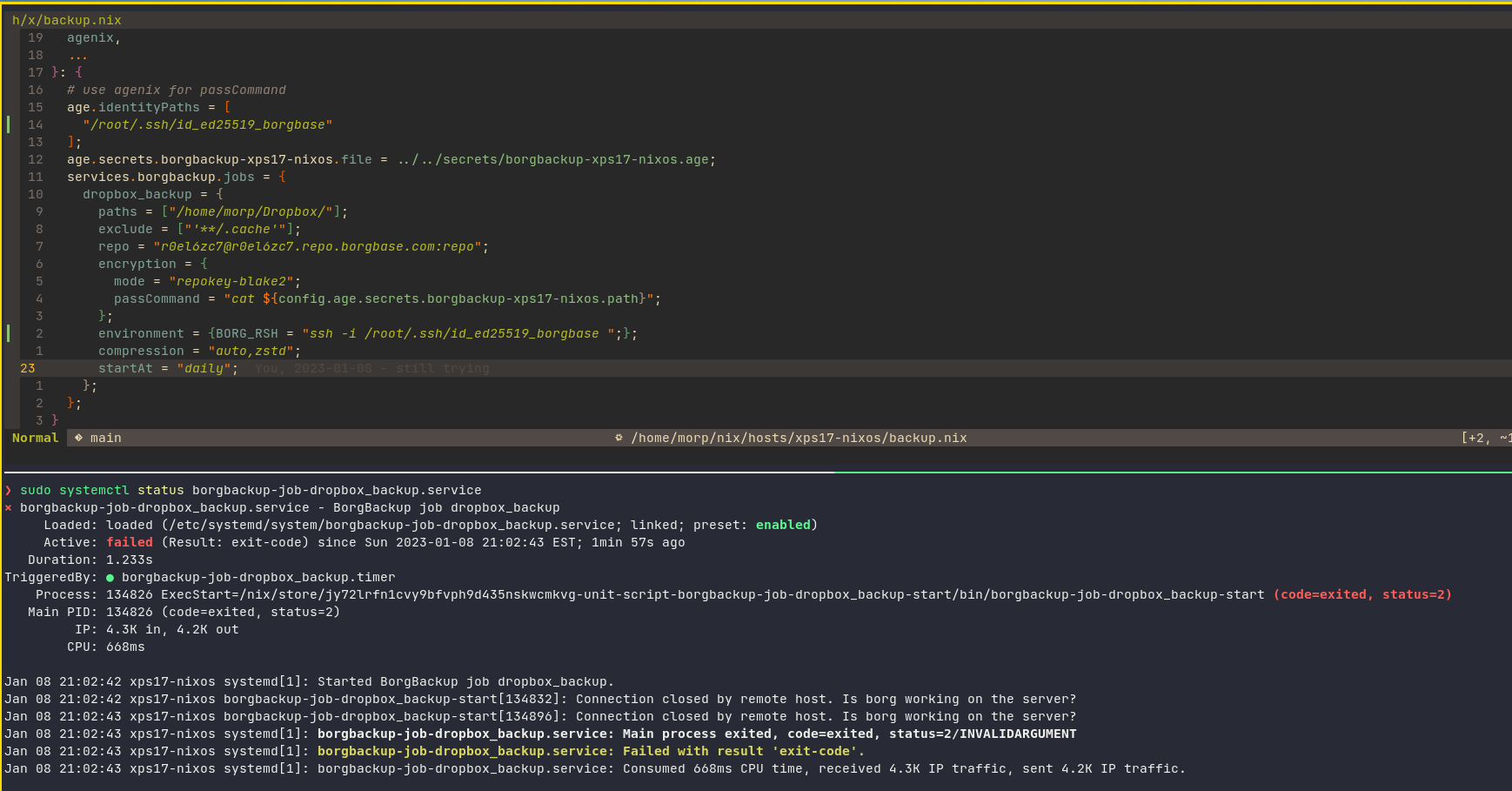

I am trying to backup my dropbox directory from my home directory to borgbase.com. I following this blog post: https://xeiaso.net/blog/borg-backup-2021-01-09 and I have looked at NixOS 24.05 manual | Nix & NixOS and https://nixos.org/manual/nixos/unstable/options.html#opt-services.borgbackup.jobs but I cannot seem to figure out the issue with why I am not the backup is not starting on borgbase. I have copied my root ssh public key to borgbase website too.
sudo ssh-keygen -N '' -t ed25519 -f /root/.ssh/id_ed25519_borgbase
This is a screenshot the nix code I have and the system status of the service created. I have also pasted the code below. Any help would be greatly appreciated.
  config,
  pkgs,
  agenix,
  # use agenix for passCommand
  age.identityPaths = [
    "/root/.ssh/id_ed25519_borgbase"
  age.secrets.borgbackup-xps17-nixos.file = ../../secrets/borgbackup-xps17-nixos.age;
  services.borgbackup.jobs = {
    dropbox_backup = {
      paths = ["/home/morp/Dropbox/"];
      exclude = ["'**/.cache'"];
      repo = "r0el6zc7@r0el6zc7.repo.borgbase.com:repo";
      encryption = {
        mode = "repokey-blake2";
        passCommand = "cat ${config.age.secrets.borgbackup-xps17-nixos.path}";
      environment = {BORG_RSH = "ssh -i /root/.ssh/id_ed25519_borgbase ";};
      compression = "auto,zstd";
      startAt = "daily";
