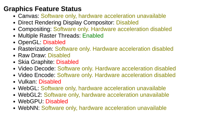

Currently facing the following while using Brave with NixOS on Wayland and Nvidia:

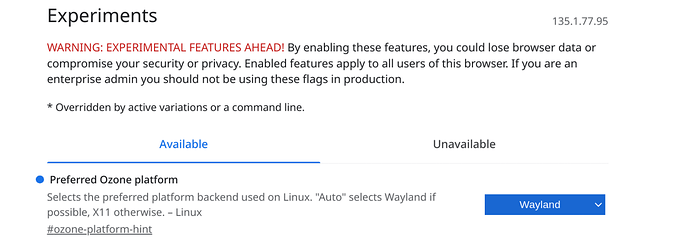

I only have the Preferred Ozone Platform tweak to fix the common window resizing glitches:
That being said, I get the same issues with both Wayland and Auto, and even setting it to X11 inside of Wayland with bridging.

Has anyone else been able to find a fix for this? Browser performance seems poor even with a powerful PC
I forgot to mention that it does the same in X11

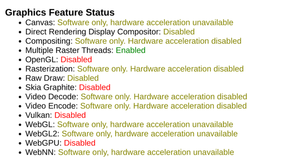

@JimJ92120 I did that as part of testing to see why hardware acceleration does not work for Brave/Chromium/Chrome
It seems to have made no impact on the hardware acceleration, so I removed the redundant entry and still face the hardware acceleration issue screenshotted above
