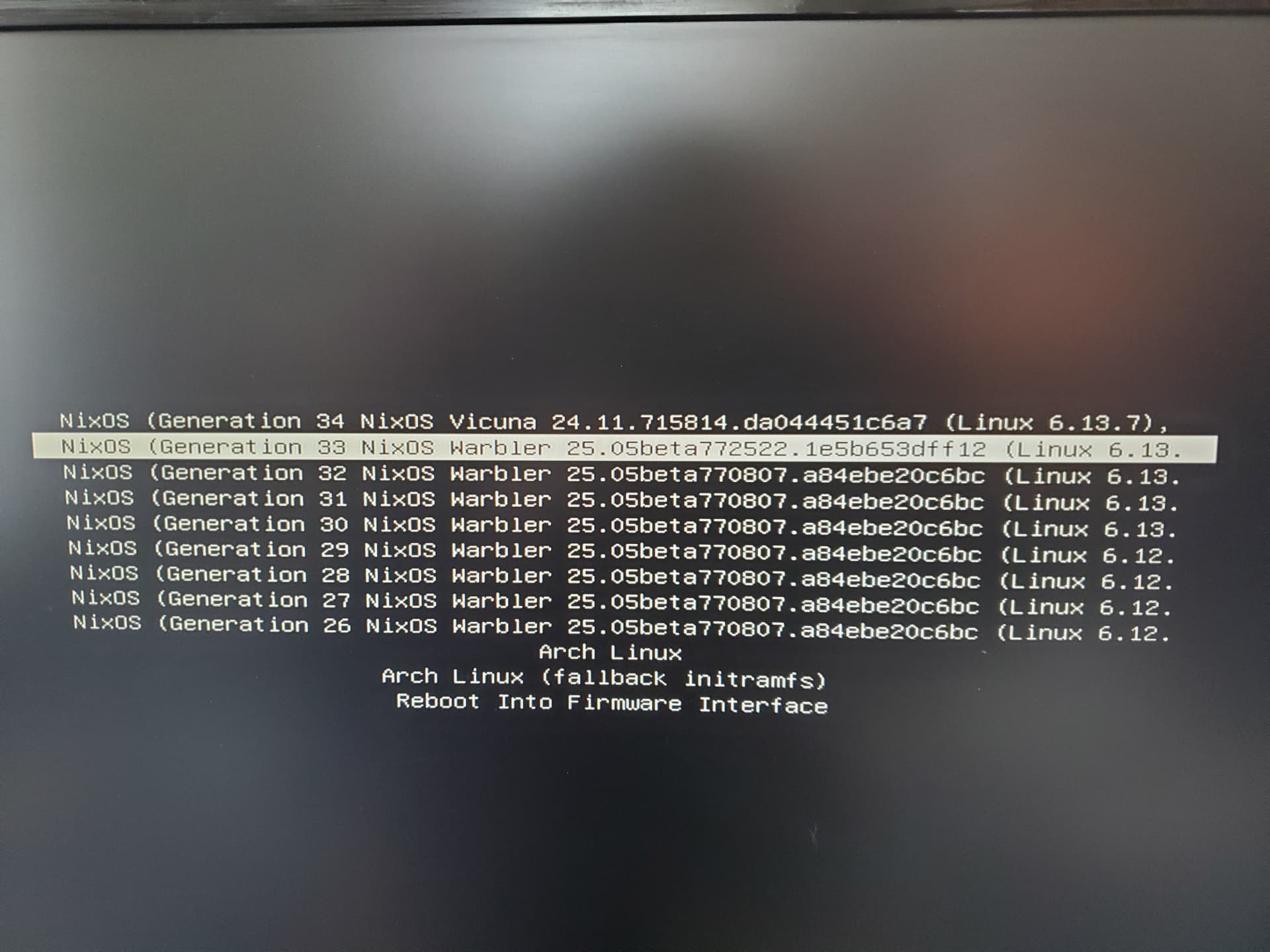

At startup I have Systemd-Boot with my generations.
I’m not sure how the installer can get broken like that.

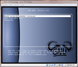

Sorry for stating the obvious but when you’re booting you see a screen similar to this one with a grub menu entry for the installer? I think there should be 4 grub entries in the latest installer.
I don’t have Grub but Systemd-Boot.
Aaah so this means you’re not booting on the USB key/installer.
From the screen you’re on select the bottom entry “Reboot Into Hardware Firmware” and then the instructions vary from motherboard to motherboard but you’ll need to find a menu where you can change the boot order, save it and reboot once more. Then you should see a screen similar to what I posted.
I don’t want Grub. I have Arch and Nixos entries in the Systemd-Boot home screen.

No one’s telling you to use grub. (In fact, I would recommend you don’t use grub whenever possible.)
All they are saying is, the live image / installer ISO uses grub, because it needs to be compatible with a wider range of systems.
So if you’re getting a systemd-boot bootloader, that’s the easy way to tell that you are not booting into the installer, you’re booting your current system.
You need to go into your firmware settings or access the firmware boot menu somehow to ensure that you are booting into the installer.
