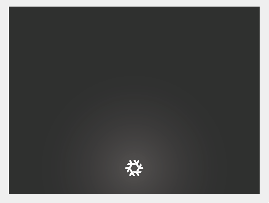

In tty, I issue the following command to start X
sudo systemctl start display-manager
The following login screen is displayed
After inputting login info, all I got is a blank screen. I tried pressing Windows key + Return, which is my config in sxhkd to open a new Terminal window, but nothing shows up
Could you please point out where I’m wrong?
