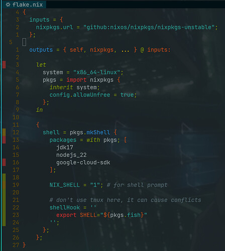

@eletrolitico i’ll try this solution, few flakes i’ve saw using this composeAndroidPackages funtion
seems that you’ve tried using android-nixpkgs
i really liked distrobox
i’ve downloaded standard android-studio deps and i’m managing them with the IDE
standard thing
the flake above is damn simple, i just want to track some programs
installed ubuntu and managed the structure in a stardard way
do you think is worth the time tracking so much deps since react native has the capability of generating android-ish gradle specs without need to change?
since distrobox keeps track of user folder, it can execute standard FHS binaries on the container, avoiding hassle with android nested dynamic deps build time download errors
despite of all, it’s always a learning adventure
IHMO, android developing is the perfect storm on NixOS
