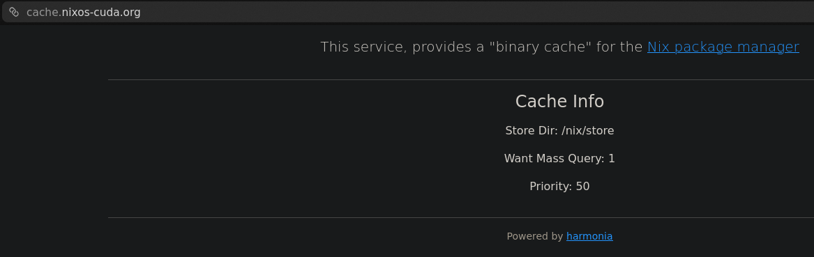

Since yesterday (December 15, 2025) the nixos-cuda team cache it’s unreachable when trying to switch a nixos system logging stuff like:
warning: error: unable to download '``https://cache.nixos-cuda.org/mhf691zwwjrqi8b6an14pblyqbzwn1v2.narinfo``': Could not connect to server (7) Failed to connect to ``cache.nixos-cuda.org`` port 443 after 6 ms: Could not connect to server; retrying in 258 ms

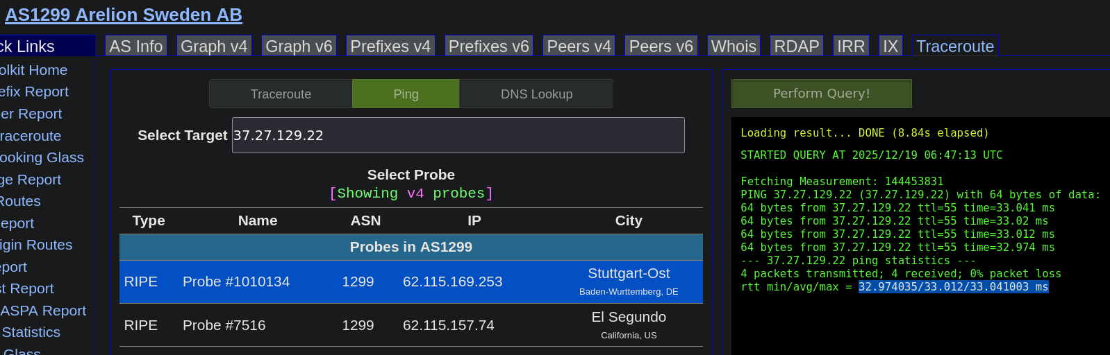

It’s weird that your traceroute doesn’t show any hop at all.
https://www.locabrowser.com/ shows that the website is reachable from various locations across the globe. What is your network location?
I see no South American country listed there tho. So I’m not sure if we can conclude that it’s reachable here.

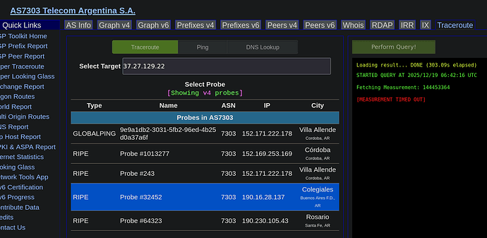

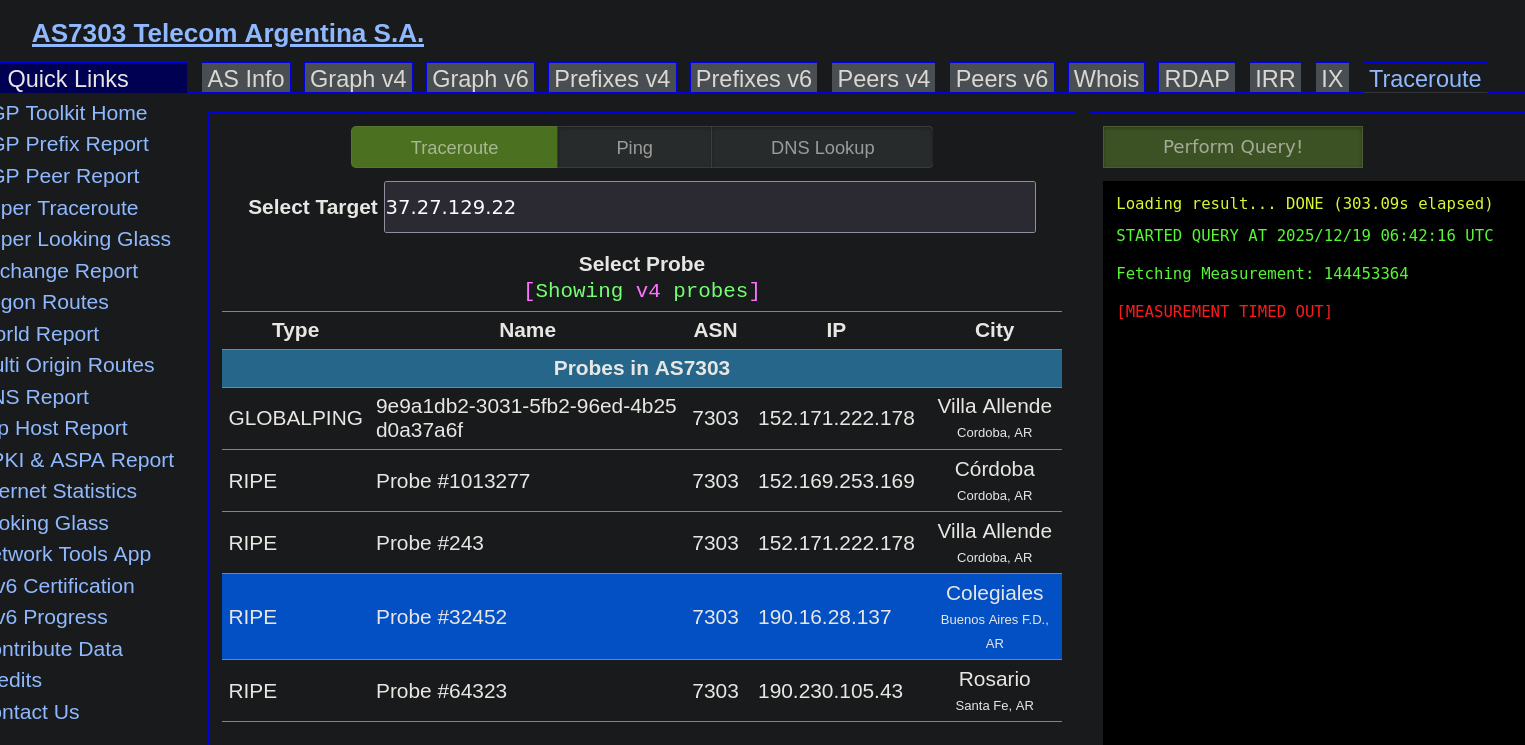

Interesting how he deduced that with so little information. Running some right now to get more information, but at this point I’m doing this more for the food for thought than anything else because I have covered from my network of friends that at least 3 ISPs from my city cannot reach the host also.
But funny enough the first one I tried from this site from another city in my country (Rosario), it’s able to reach the host no problem:
ROSARIO ARGENTINA Ping results for: 37.27.129.22 (static.22.129.27.37.clients.your-server.de)
Target: 37.27.129.22 with 64 data bytes Success rate sent/received = (1/1) packets
Round-Trip min/avg/max = 243ms/243ms/243ms
But also Buenos Aires as well:
BUENOSAIRES ARGENTINA Ping results for: 37.27.129.22 (static.22.129.27.37.clients.your-server.de)
Round-Trip min/avg/max = 240ms /240ms /240ms
Ok, seems like that from my AS it’s not able to make a ping to this IP which it’s reasonable because my IP lives there and I cannot connect as well.
Do you think this is somewhat reportable somewhere? lol
