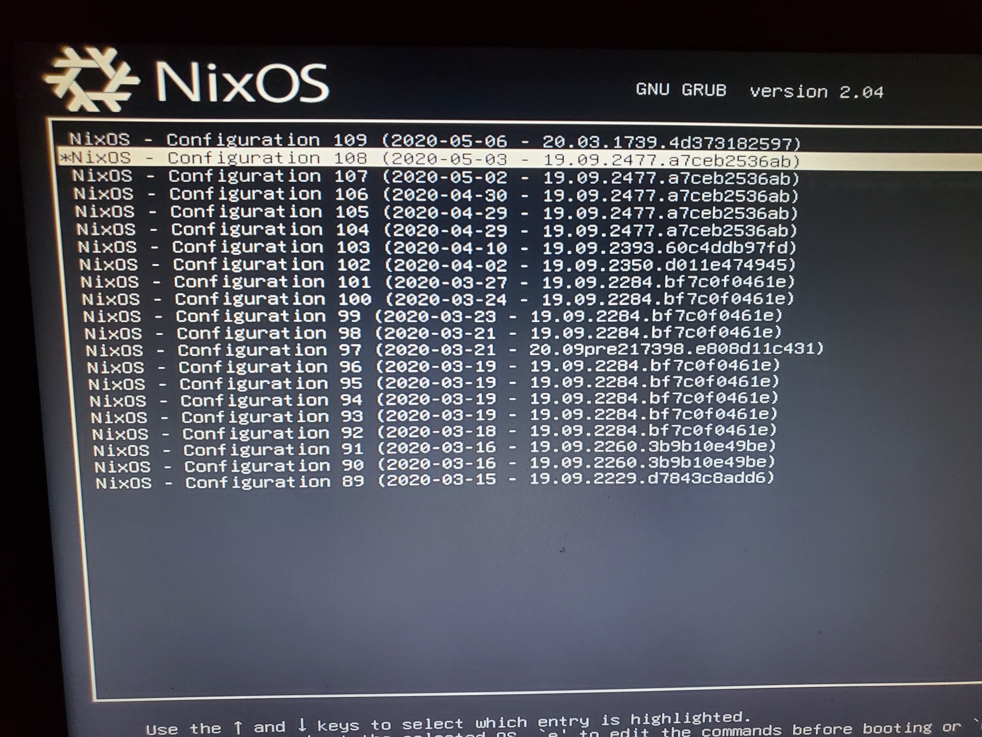

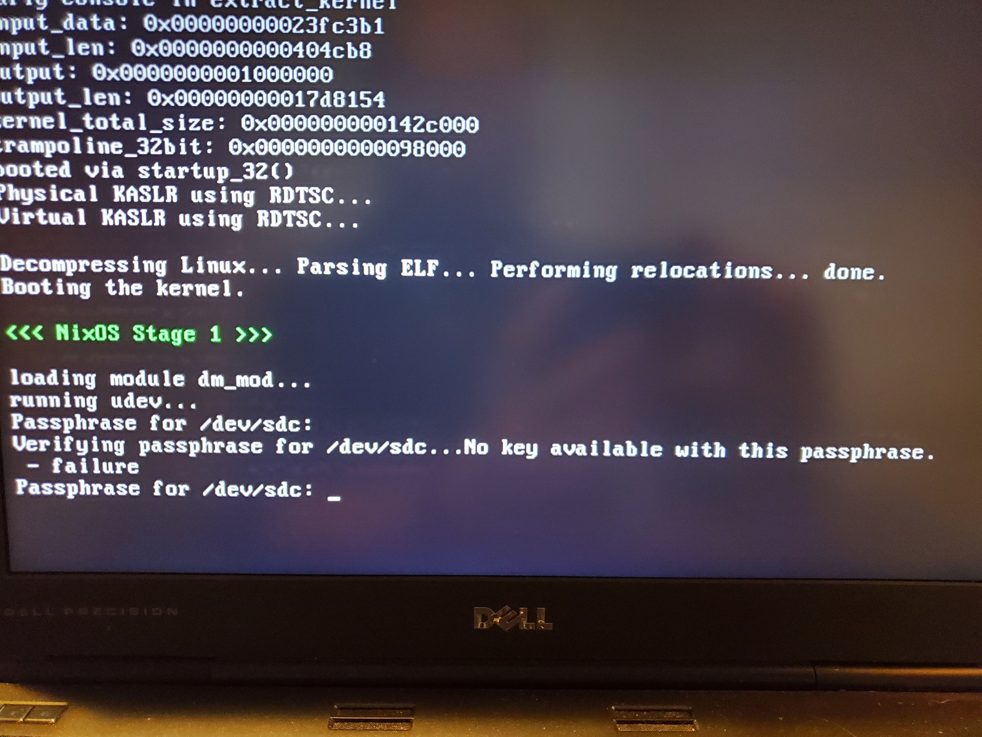

I recently tried to upgrade from 19.09 to 20.03. It seemed to work fine but I was unable to boot. I took some pictures of the error.
This is the grub entry
Switching back to 19.09 this is the normal error I get when the passphrase is wrong

I’m not really sure what is going on. This setup has work for the past few years and I’m not sure where to start. Have any of the options changed for these settings?
You should probably boot into 19.09 and rebuild with disks specified via /dev/disk/by-id. It’s possible the drive letters changed with the update.
Thanks I will try that out.
I used by-uuid and it worked. Thanks for the help!
