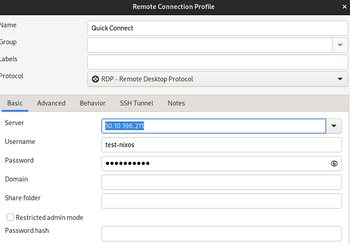

Can you share settings in Remmina to access the remote host?
I never had to add any port using default / basic setting in Remmina
Here’s a profile for a test remote (LXC container):
