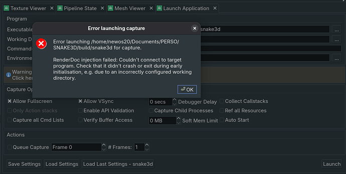

Yes, it’s the packaged version. Launching qrenderdoc itself works just fine for me too, but the problem arise when you try to launch an application using the “launch” button :
And the error reported in the terminal is “could not load SDL3”.
I think that this is renderdoc throwing the error, since launching the application without it works just fine, but I’m not completely sure…
