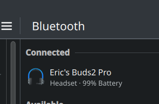

  1. Pair headset with laptop, verify it works
  2. Disconnect and reconnect in the settings panel, verify it works

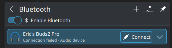

  3. Turn off Bluetooth, wait a couple of seconds, turn on Bluetooth
  4. Attempt connecting to the previous headset
  5. Observe connection failure
When the connection fails, the spinner in the Bluetooth panel spins for 20~30 seconds and then displays the following:
