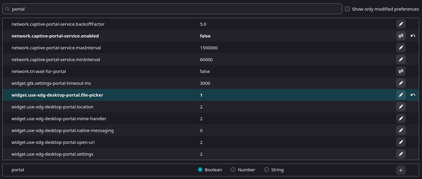

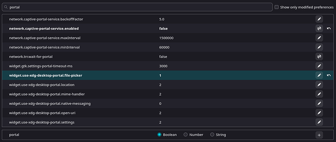

I had tried all of the above which has worked in the past. Recently on a new install (using LibreWolf, but still). I solved it by changing the highlighted setting to 1 in about:config
