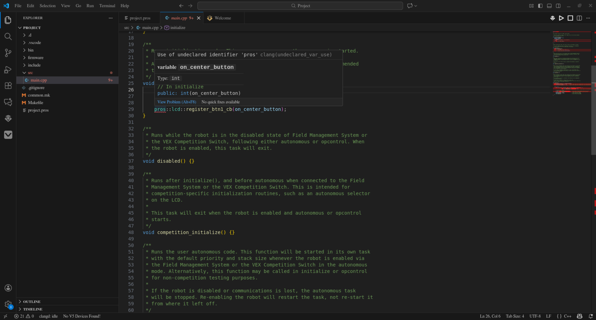

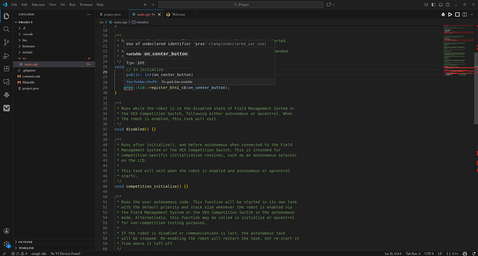

Hello. I am trying to program for my Robotics team on my laptop, and we use Visual Studio Code with the ‘PROS’ Library for C++ (which has everything we program with). Whenever I look main.cpp, all of the functions & otherwise given to me by the library are said to be undeclared. I am sure this means it is not working somehow.

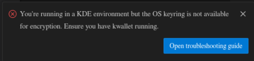

As far as I understand, this is telling me that I need a keyring that doesn’t exist on my device. I am not sure if getting this keyring will solve the problem since it seems (sort of) separate. I do not know what kwallet is.

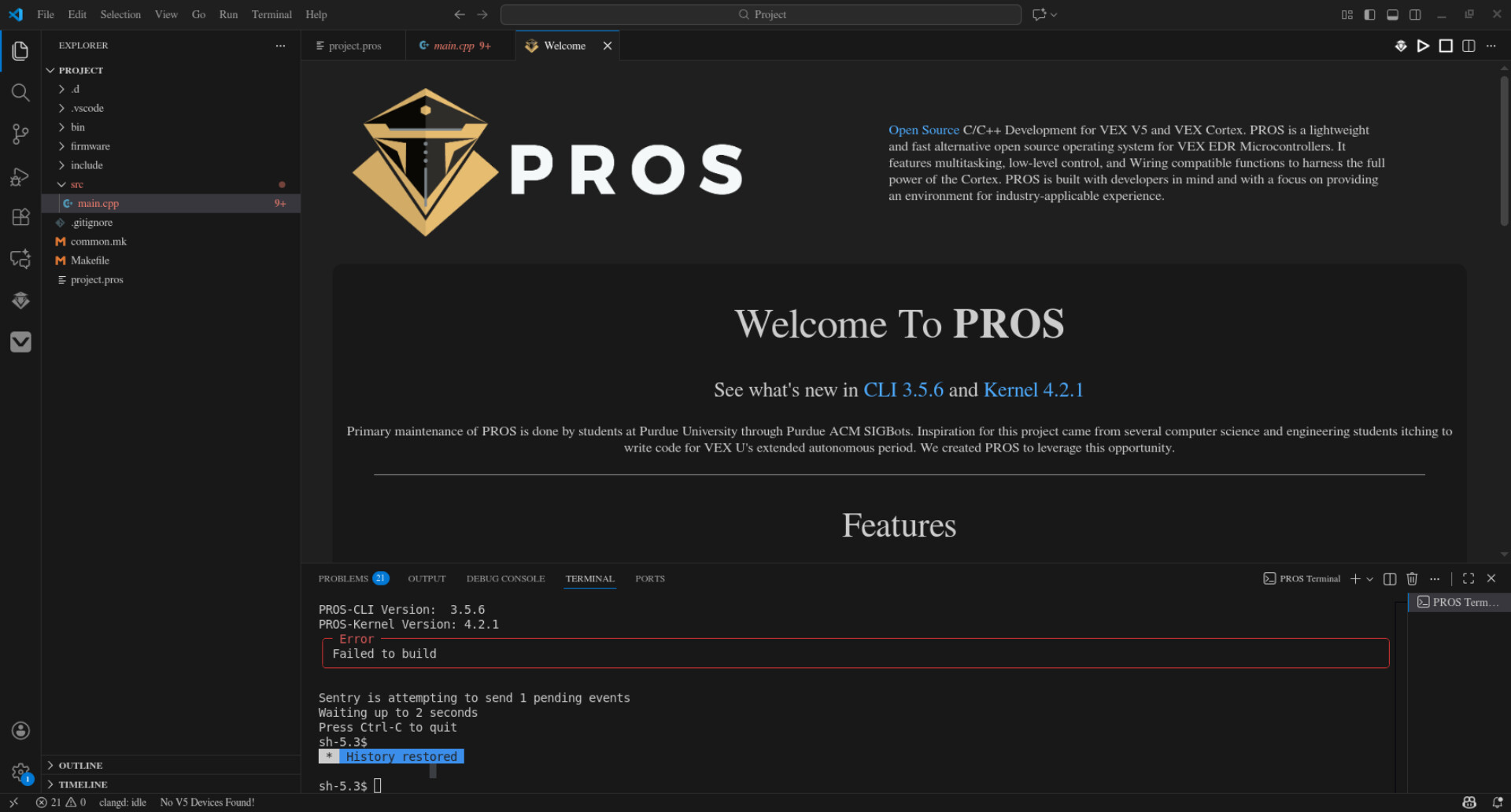

Have you set-up a devshell correctly and can you build your project from within that? If yes, have you tried to enter your shell and then open VScode from within this shell, does it then find the libraries necessary?

I have done research on devshells, and have so far created this Shell.nix file:

Though I have been able to figure out how to enter the shell through the bash command line, I have not been able to figure out how to:
  1. Open VS Code through that shell
  2. Get my Kwallet keyring to cooperate with VS Code (not sure if this is a related issue, but it seems noteworthy)
  3. Figure out what to even call the PROs library in my .nix file, since I’m 100% sure that library isn’t any kind of nix/linux package.
  1. You enter code in your shell and hit enter.after entering the devshell
  2. No clue, I used keepassxc with vscode and it worked fine
  3. I don’t know what this “PROs library” is, but if it’s not in nixpkgs, you’ll have to write a drv (“package”) you can use. Maybe even contribute it to nixpkgs.
