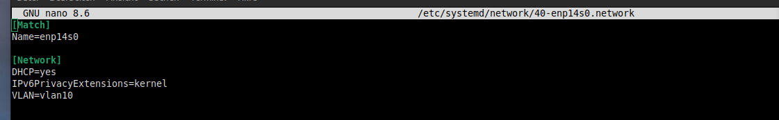

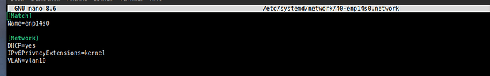

mpfhh … this hasn’t worked… but to deepen the problem… boot new i have the following entries under ip a
[holger@nixos:~]$ ip a
1: lo: <LOOPBACK,UP,LOWER_UP> mtu 65536 qdisc noqueue state UNKNOWN group default qlen 1000
    link/loopback 00:00:00:00:00:00 brd 00:00:00:00:00:00
    inet 127.0.0.1/8 scope host lo
       valid_lft forever preferred_lft forever
    inet6 ::1/128 scope host noprefixroute
2: enp14s0: <BROADCAST,MULTICAST,UP,LOWER_UP> mtu 1500 qdisc fq_codel state UP group default qlen 1000
    link/ether 10:ff:e0:3f:08:d4 brd ff:ff:ff:ff:ff:ff
    altname enx10ffe03f08d4
    inet 192.168.38.145/24 metric 1024 brd 192.168.38.255 scope global dynamic enp14s0
       valid_lft 86395sec preferred_lft 86395sec
    inet6 fe80::12ff:e0ff:fe3f:8d4/64 scope link proto kernel_ll
3: wlp13s0: <BROADCAST,MULTICAST> mtu 1500 qdisc noop state DOWN group default qlen 1000
    link/ether ec:91:61:26:81:2f brd ff:ff:ff:ff:ff:ff
    altname wlxec916126812f
4: vlan10@enp14s0: <BROADCAST,MULTICAST,UP,LOWER_UP> mtu 1500 qdisc noqueue state UP group default qlen 1000
    inet 192.168.38.4/24 brd 192.168.38.255 scope global vlan10
you see the enp14s0 also got an IP (automatic) … why? I run the script …see ip a as follows
    inet 192.168.38.4/24 scope global vlan10
no matter what i do, in the configuration.nix…without ip it is right…
every by new boot … :nauseated_face: i want DHCP = no
