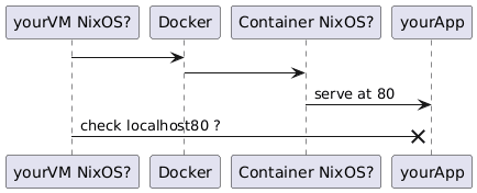

I’ve tried several different types of containers with no luck. I’m perfectly find continuing with docker-compose in Nixos as I’d like to get off my Debian box. But running that appeared to work, then it’d fail as none of the ports were actually working. Then I attempted a more nixified way from github but it too appeared to create then not be accessible via localhost:port.
I took this to nextcloud which Nix has it packaged nicely. Nextcloud - NixOS Wiki the default configuration didn’t work. Nothing ever seems to get through the invisible firewall, which i’ve tried disabling as well adding the ports.
Not sure what commands to pull out to dig deeper at what’s going on.
