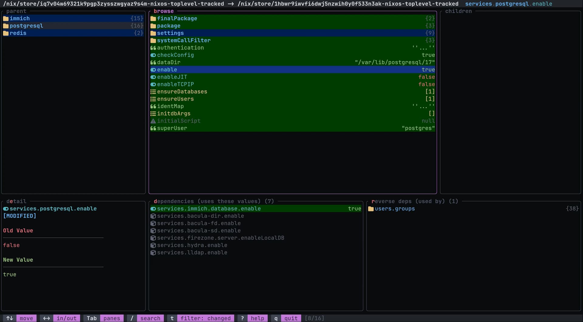

The terminal utility looks like this:

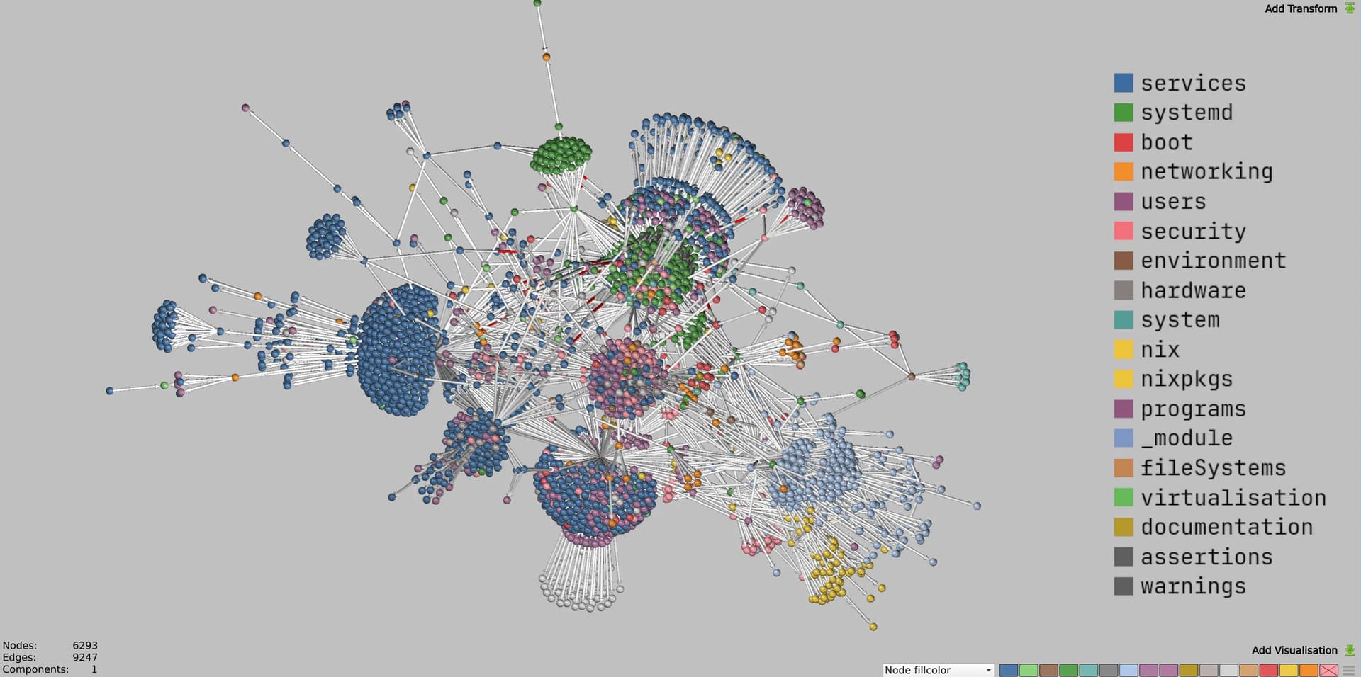

And here is a graph showing how options of a minimal NixOS configuration depend on each other (only showing options that were actually evaluated):
