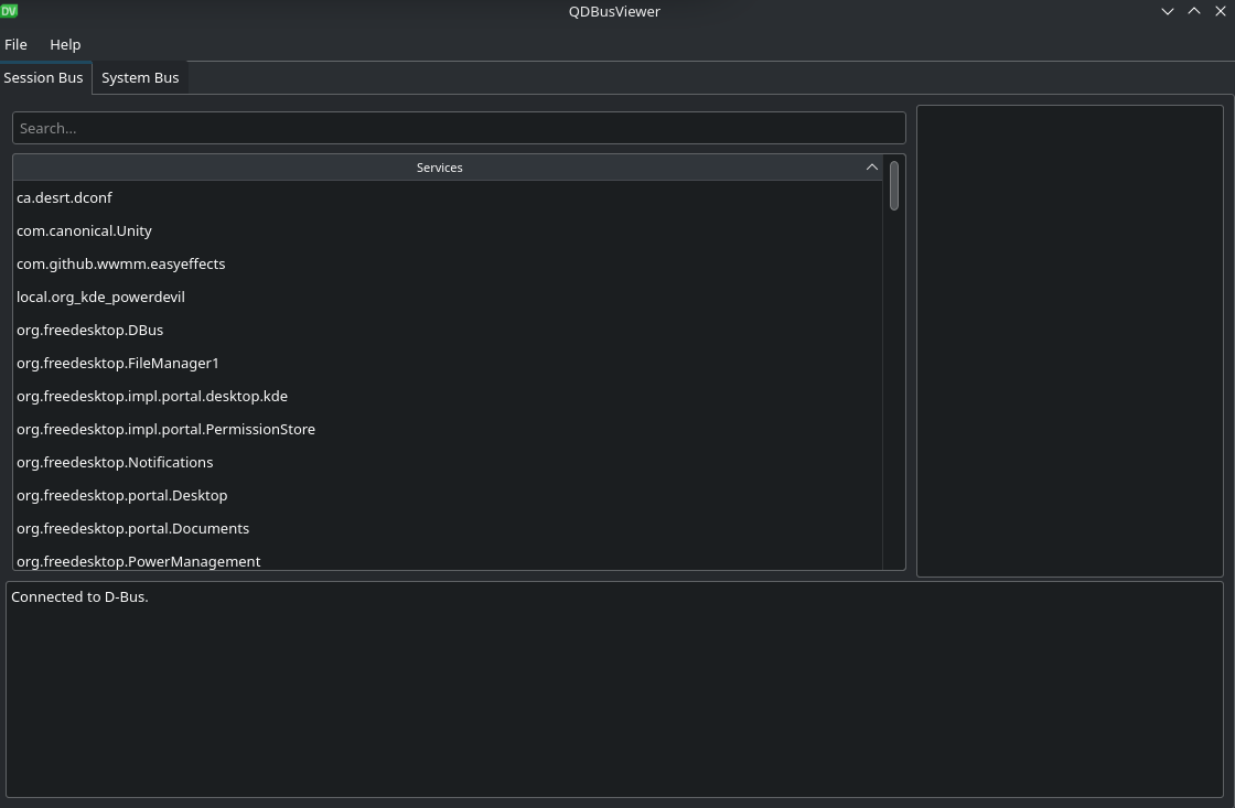

Hi, could you post the qdbus log (with qdbusviewer for example) when you plug the monitor in?
Also, more information would be appreciated, what the system is, the GPU, ETC.
Host is a Lenovo Legion 5 Pro 16ach6h with an AMD 5800H and 3070m dGPU.

Not too sure about what part I should be looking at for this :sweat_smile:
Oh, no worries, I should have just said to post the output of dbus-monitor.
