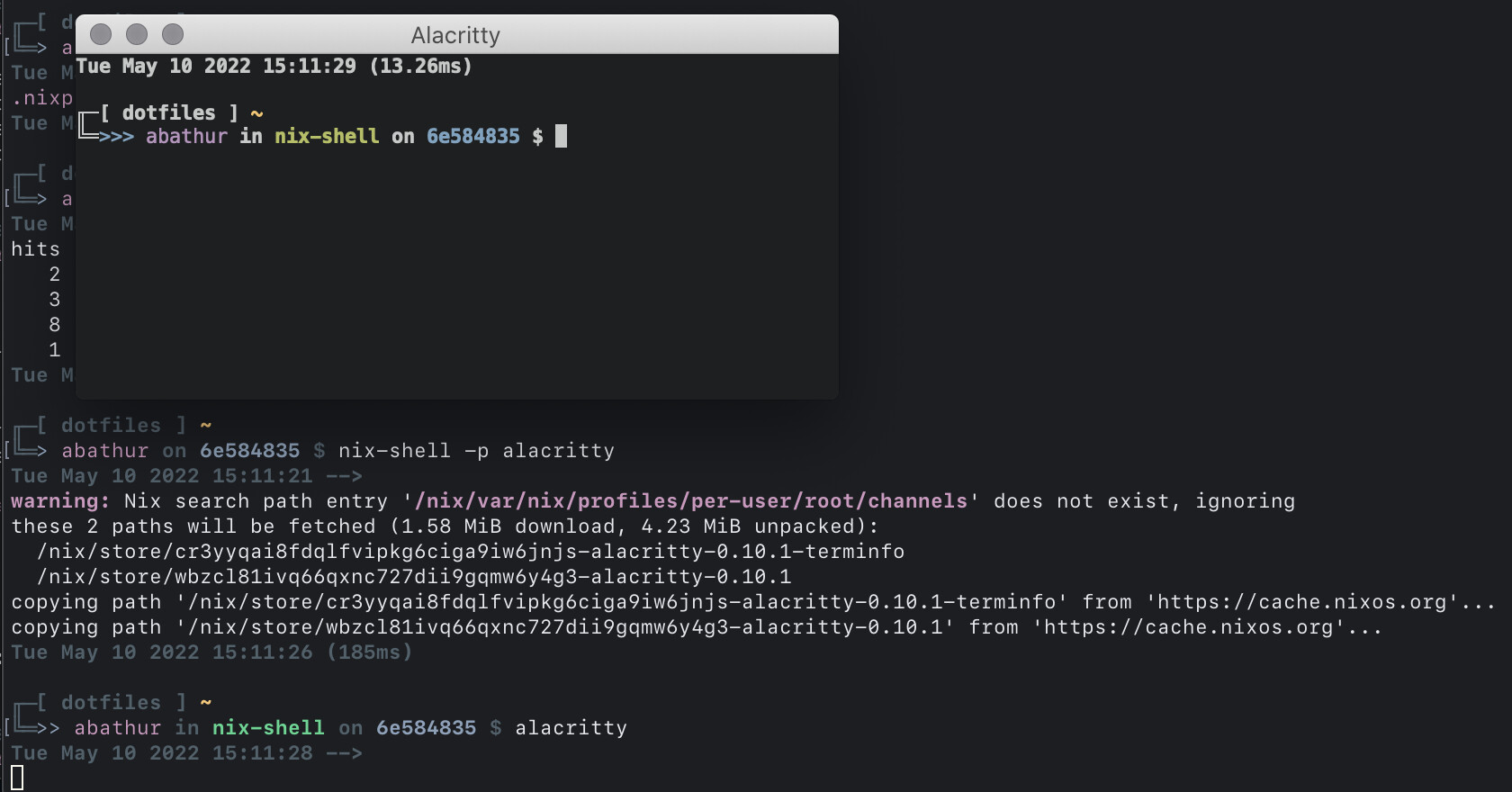

Here’s a screenshot of me running alacritty on macOS:
