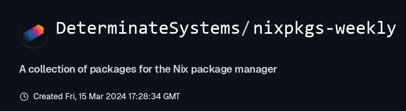

but are they not just mirroring nixpkgs?
It’s awfully convenient that they have the solution ready to go for you
but they have nixpkgs-weekly since 2024
