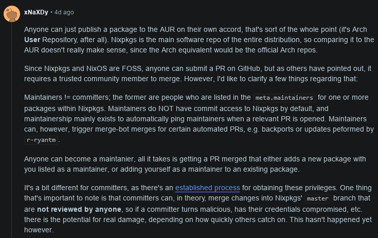

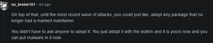

However, on reddit, there are commentaries such as:

That’s incorrect, only committers (in nixpkgs vocabulary) can merge their own PRs, and becoming a committer has its own review process that requires a fair amount of participation and trust in the community. Hence, the blog post is intentionally lying with terminology to cause fear, uncertainty, and doubt.
Can that committer trust be abused? Of course, same as any other open source project where someone built up years of goodwill only to throw it away, but a cooldown won’t solve that. If self-merges were banned, a malicious committer could easily create a sockpuppet account to submit PRs from, and build up goodwill with that account too.
