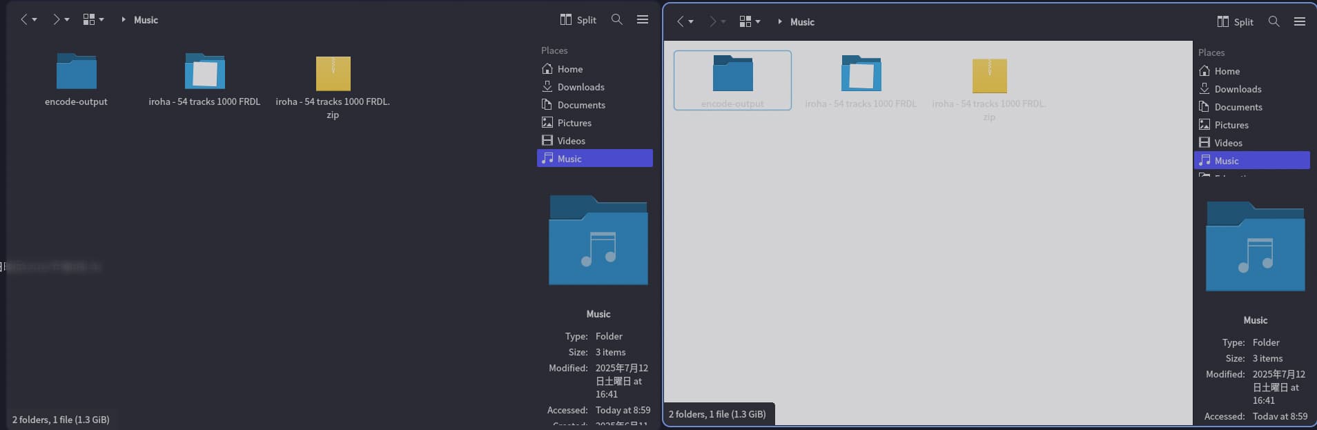

Hello everyone.
I am on NixOS unstable with a flake-based setup. I am using Hyprland and do not have the plasma desktop installed.

The issue I am facing is that dolphin does seem to know about neither which applications are installed on the system nor with which MIME types they are associated with.

When opening dolphin or running kbuildsycoca6 after rm ĀØ/.cache/ksycoca* the error message
"applications.menu" not found in QList("/etc/profiles/per-user/n/etc/xdg/menus", "/run/current-system/sw/etc/xdg/menus") is displayed.

Thank you for the suggestion. However, the main goal of the overlay was specifically to reduce dependencies on other KDE modules that aren’t directly needed.
While plasma-workspace might work as a solution, I’d prefer to avoid introducing dependencies on the broader Plasma desktop environment when the core functionality can potentially be achieved with minimal dependencies.
I noticed that libsForQt5.kservice is already included in the install, and its only purpose here is for creating the application list which seem to include all of the desktop entries.
Hello - I was researching dolphin’s MIME issues when I came across this thread. Thank you for sharing this excellent overlay!
However, after using this, I encountered an issue where some themes became corrupted.
The left image shows the state before applying the overlay, while the right shows the state after.
Has anyone else experienced a similar problem?
