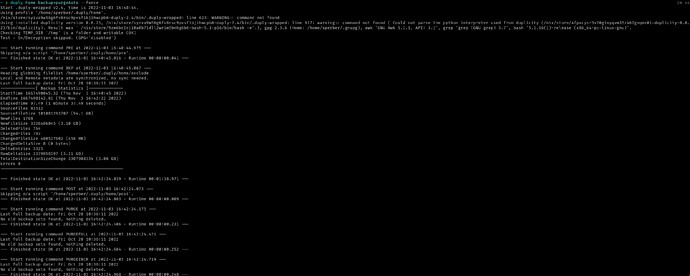

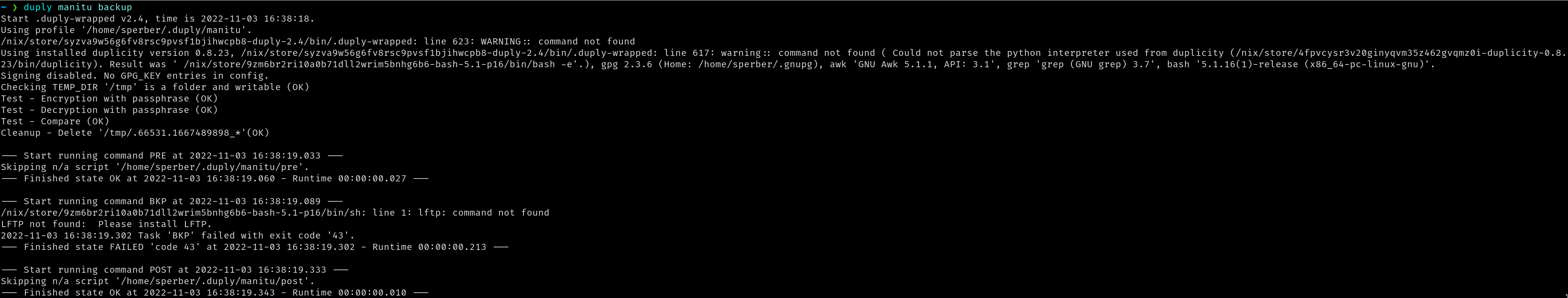

Let me show you 3 Screenshots, maybe this is helpful:
First, my local backup, which succeeds:
Second, the failed backup to ftps:

So, something is up either with lftp or some encryption service.
oooh the wrapper is incorrectly done:
it resets the PATH instead of adding to it with --prefix PATH :
